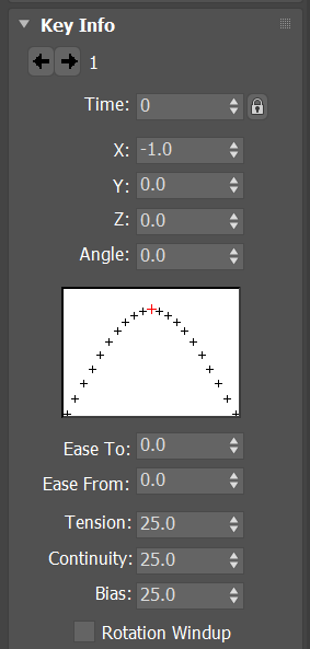

TCB controllers display their properties in a Key Info dialog in Track View and a single Key Info rollout in the Motion panel.
Time field
Specifies when in time the key occurs.
Time Lock
Prevents horizontal key motion in Track View edit modes.
Key Value fields
Stores the animation values for the key. The number and meaning of the fields vary with different parameter data types. Some typical field arrangements are:
  • XYZ fields for Position and Point3 keys
  • XYZ percentage fields for Scale keys
  • A single value field for Float keys
TCB Graph
Charts the effect that changing the controller properties will have on the animation. The red mark at the top of the curve represents the key. The marks to the left and right of the curve represent an even division of time to either side of the key.
The TCB graph is a stylized representation of the animation around a single key. If you want to view the effect of changing TCB properties on the true animation curve, use the Function Curves mode of Track View (works only with position and scale).
The following descriptions refer to both the TCB graph and the function curve as the animation curve.
Note: When you are changing the properties of a selection of multiple keys, the TCB graph is blank unless all properties are equal.
Ease To
Slows the velocity of the animation curve as it approaches the key. Default=0.
High Ease To causes the animation to decelerate as it approaches the key.
The default setting causes no extra deceleration.
Ease From
Slows the velocity of the animation curve as it leaves the key. Default=0.
High Ease From causes the animation to start slow and accelerate as it leaves the key.
The default setting causes no change of the animation curve.
Tension
Controls the amount of curvature in the animation curve.
High Tension produces a linear curve. It also has a slight Ease To and Ease From effect.
Low Tension produces a very wide, rounded, curve. It also has a slight negative Ease To and Ease From effect.
The default value of 25 produces an even amount of curvature through the key.
Continuity
Controls the tangential property of the curve at the key. The default setting is the only value that produces a smooth animation curve through the key. All other values produce a discontinuity in the animation curve causing an abrupt change in the animation. Default=25.
High Continuity values create curved overshoot on both sides of the key.
Low Continuity values create a linear animation curve. Low continuity creates a linear curve similar to high tension except without the Ease To and Ease From side effect.
The default setting creates a smooth continuous curve at the key.
Bias
Controls where the animation curve occurs with respect to the key. Default=25.
High Bias pushes the curve beyond the key. This produces a linear curve coming into the key and an exaggerated curve leaving the key.
Low Bias pulls the curve before the key. This produces an exaggerated curve coming into the key and a linear curve leaving the key.
The default setting distributes the curve evenly to both sides of the key.
