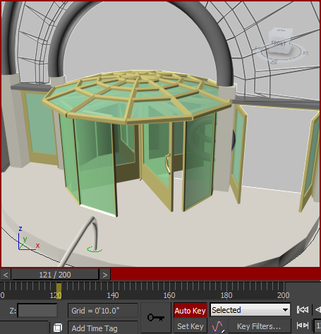

In this tutorial, you will learn how to model and animate in 3ds Max by constructing an animated revolving door for a hotel lobby. In the course of doing so, you'll learn about creating objects and transforming them.
This tutorial also teaches how to use snaps and pivot points for alignment, as well as general user-interface navigation skills. You'll learn to instance objects and link them into an animated hierarchy. You'll also learn to merge files together.

  • Create a revolving door by using primitive and AEC objects.
  • Apply materials to objects and sub-objects.
  • Animate the doors in the scene using rotation transforms and parametric animation.
  • Merge objects from another file into your scene.
