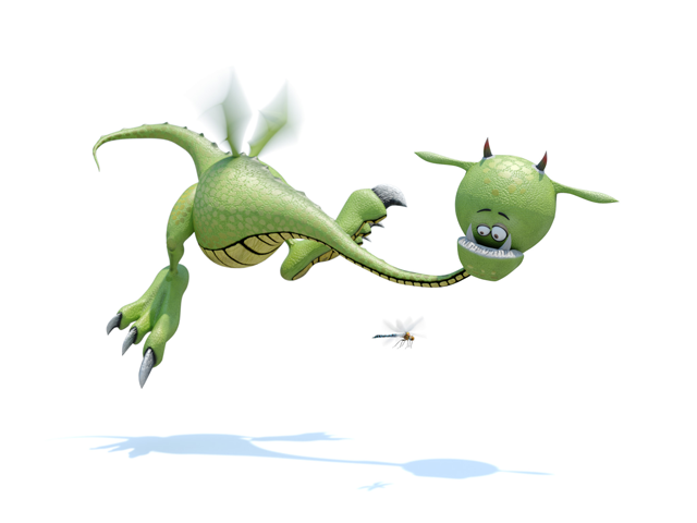

Artist: Roberto Ziche

CAT (Character Animation Toolkit)
CAT, while quite advanced, is in some ways the simpler of the two character-animation systems. With CAT, you can more easily rig and animate multi-legged and non-humanoid characters; it is also capable of animating humanoid characters quite realistically. Among the rigs built into CAT are a number of multi-limbed creatures such as a dragon with four legs and two wings, a spider, and a centipede with 18 legs. You can easily animate these along paths with no foot sliding using the graph-based CATMotion editor. CATMotion is best suited for modifying cyclical motion in real time by adjusting parameters for body parts such as the pelvis; parameters include Twist, Roll, Pitch, Lift, and Push.
Another powerful but relatively easy-to-use feature of CAT is the layering system, available both in CATMotion (for individual body-part cycles) and at the full-rig level, with keyframed weighting at both levels. The latter context supports color-coding of layers so it’s easy to see which layer is contributing to the motion at any given moment. CAT also supports blending between FK and IK for custom control.
Last, CAT provides muscle and muscle strand objects for simulating character musculature.

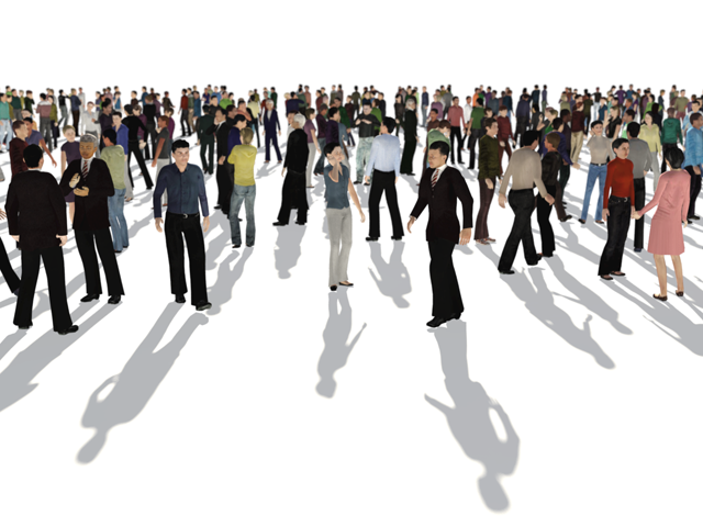

- Populate
Populate has tools for quickly animating people moving along routes such as paths and sidewalks, as well as hanging out in specific areas, both sitting and standing. It lets you adjust the crowd appearance by controlling the characters' look, actions, interaction, speed, resolution, and so on. You can further customize the look and animation of a Populate crowd with traditional manual editing, using saved textures and baked animations.
The Populate character animation feature is ideal for producing scenes that contain many people.
