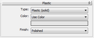

- Type
Lets you choose the material type.
- Plastic (solid) (The default.)
- Plastic (transparent)
- Vinyl
- Color
Sets the color of the material.
- Use Color (The default.) When this is active, a color swatch lets you choose the color.
- Use Map When this is active, a map button lets you choose the map for the color.
Color By Object Uses the object's
3ds Max wireframe color as the paint color.

- Finish
Sets the surface finish and reflectivity of the material.
- Polished
- Glossy
- Matte

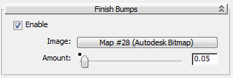

Finish Bumps rollout
Finish Bumps adds a bump pattern such as you might find on vinyl siding or flooring.
- Enable
When on, the material uses the bump pattern. Default=off.
- Image
Click to specify a bitmap for the bump pattern.
- Amount
Controls the height of the finish bumps. Range: 0.0 to 1.0. Default=0.05.

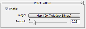

Relief Pattern rollout
- Enable
When on, applies a relief pattern to the material. Default=off.
- Image
Click to specify a bitmap for the relief pattern.
- Amount
Controls the height of the relief. Range: 0.0 to 2.0. Default=0.25.
