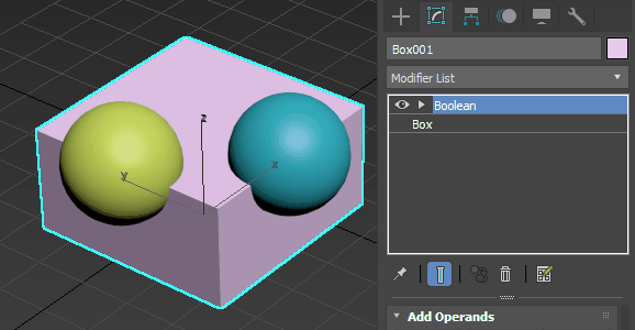

- When using the Boolean modifier, edge seams at the intersection of boolean operations are passed up the stack to be used with other modifiers. In the following example, two spheres have been subtracted from a box. An
Edit Poly modifier is applied to the Box. When the
Edge sub-object level is enabled, all the boolean edge seams are selected.
