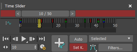

  1. Click to turn it on.
    The button turns red to show you are now in Set Key mode. In this mode, you can try out ideas before you commit to them.

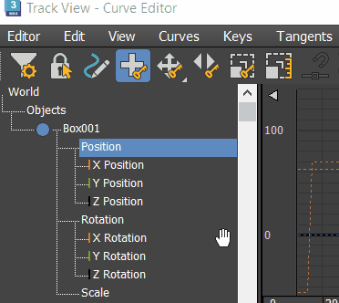

  2. Open Track View (either Curve Editor or Dope Sheet).
  3. In the Track View View menu, click (Keyable Icons).
  4. Turn off all the tracks that you don't want to keyframe.
    The circled key means the track will be keyed. If you click the circled key, it turns to a crossed key , which means that track will not be keyed.
    Tip: You can toggle multiple tracks as keyable by using the Edit menu Controller submenu Keyable command.
    When you are finished, minimize or close Track View.
  5. Click and use the Set Key Filters dialog to enable the tracks you want keyframed.
    Position, Rotation, and Scale are on by default. So is IK Parameters.
    You can use Key Filters to work on individual tracks selectively. For example, if you are in Track View and the Rotation and Position tracks of a character's arm are keyable, you can use the key filters to turn off the Position filter and only work on the Rotation tracks.
  6. Move the time slider to another point in time, transform your objects or adjust parameters in the command panels to create animation.
    This does not yet create keyframes.
  7. Click (Set Keys) or press K on the keyboard to set a key.
    When the Set Keys button turns red , it sets a key on the time ruler. The keys are color coded to reflect which tracks are being keyed.
    If you don't click Set Keys and you move to another point in time, the pose is lost.
    Tip: To move the pose to another point in time, hold down the right mouse button while dragging the time slider.
