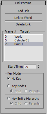

Once you assign a Link constraint, you can access its properties on the Link Params rollout in the Motion panel. In this rollout you can add and delete targets and animate the time at which each target becomes the active parent of the constrained object.
You can also modify the animation of link frames by manipulating the keys on the track bar and in Track View. However, standard methods for deleting keys in those contexts do not apply to link keys; you must use the Delete Link function on the Link Params rollout instead.
- Add Link
- Adds a new link target.
After clicking Add Link, set the time slider to the frame at which to activate the link, and then select the object to link to. You can continue adding links as long as Add Link is on; to exit this mode, right-click in the active viewport or click Add Link again.
- Link to World
- Links the object to the world (the scene as a whole).
We recommend this be the first target in the list. This prevents the object from reverting to its independent creation or animation transforms if other targets are deleted from the list.
- Delete Link
- Removes the highlighted link target. Once a link target is removed, it will no longer influence the constrained object.
- [target list]
- Shows the link target objects.
- Start Time
- Assign or edit the frame value of a target.
When you highlight a target entry in the list, Start Time shows the frame at which the object becomes a parent. To change when the link transfer takes place, adjust the value.
Tip: You can also modify the animation of link frames by manipulating the keys on the track bar and in Track View.
Key Mode group
- No Key When chosen, no keyframes are written to the constrained object or its targets. The link control happens without inserting any keys.
- Key Nodes When chosen, keyframes are written to the specified option. There are two options: Child and Parents. Child sets a keyframe only on the constrained object. Parents sets keyframes for the constrained object and all of its targets.
- Key Entire Hierarchy Sets keyframes up the hierarchy for the specified option. There are two options: Child and Parents. Child sets a keyframe only on the constrained object and its parents. Parents sets keyframes for the constrained object, its targets, and their upper hierarchy.
