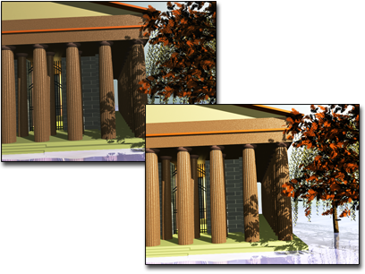

Above: Original rendering is too dark.
Below: Increasing both brightness and contrast improves clarity of the rendering.
