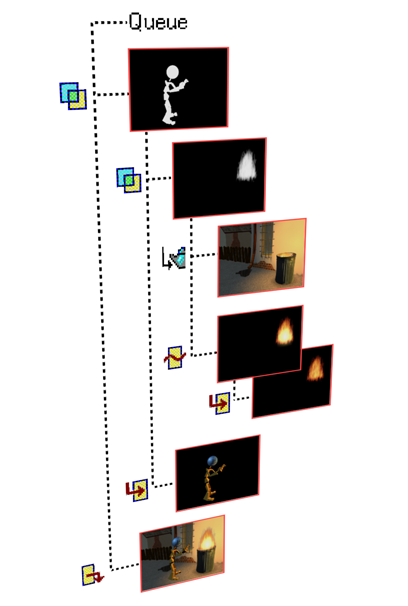

Video Post, available from the Rendering menu, lets you combine (composite) and render output of various types of events, including the current scene, bitmap images, image-processing functions, and so on.
A video post queue can include scene geometry, background images, effects, and masks for compositing them.
The result of video post: a composited frame
