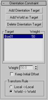

Once you assign an Orientation constraint, you can access its properties on the Orientation Constraint rollout in the Motion panel. You can use this rollout to add and delete targets, assign weighting, assign and animate target weight values, and adjust other related parameters.
- Add Orientation Target
- Adds new target objects that influence the constrained object.
- Add World as Target
- Aligns the constrained object to the world axis. You can weight the amount of influence that the world target has on the constrained object as you would any other target object.
- Delete Orientation Target
- Remove targets. Once removing the target, it will no longer influence the constrained object.
- [target list]
- Shows the targets and their weights.
- Weight
- Assigns and animates weight values for each target.
- Keep Initial Offset
- Preserves the original orientation of the constrained object. When you turn off Keep Initial Offset, the object adjusts itself to match the orientation of its target or targets. Default=off.
Transform Rule group
When an orientation constraint is applied to an object that is part of a hierarchy, this determines whether the local node transform or the parent transform will be used for the orientation constraint.
- Local –>Local When chosen, the local node transform is used for the orientation constraint
- World –>World When chosen, the parent or world transform will be applied, rather than the local node transform.
