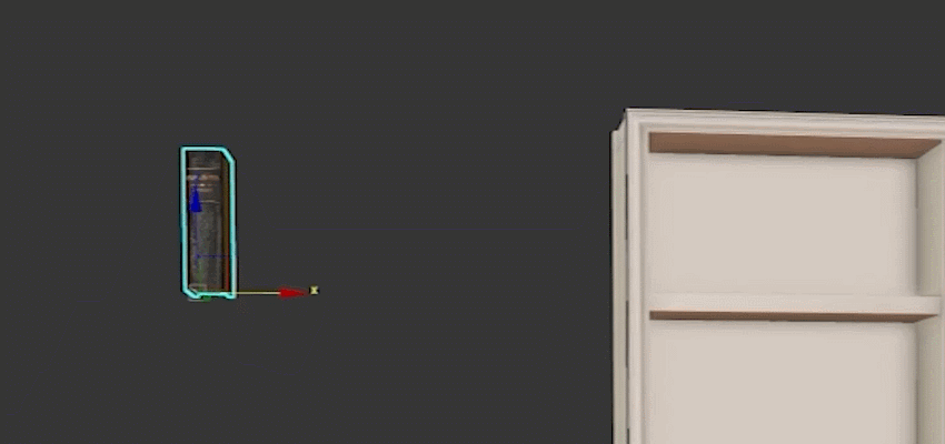

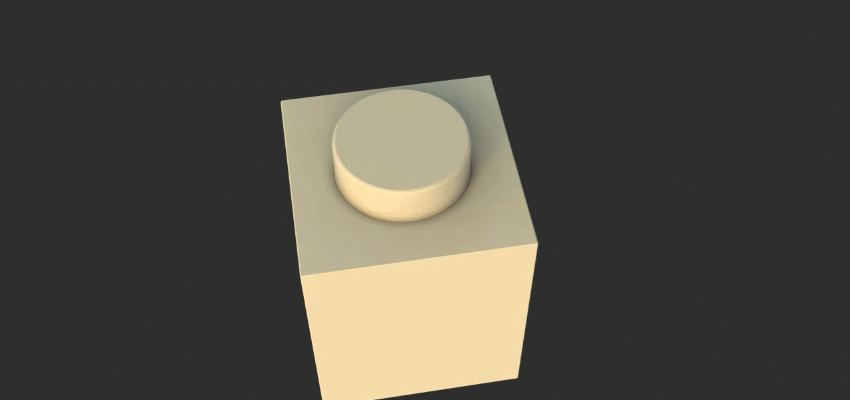

The parametric Array modifier lets you create arrays using multiple Distribution methods. Its expansive toolset includes transformation and randomization controls, and parameters to adjust material IDs and UV data.
With an expansive toolset and a location in the stack, the Array modifier provides additional flexibility not found in the Array command. Most importantly, this modifier is parametric, giving you the ability to adjust parameters after an array has been created.
- Stiches on a surface
- Bolts on an airplane wing
- Bricks for a wall
- Books on a bookshelf
- Grid: Creates a uniform set of clones in a 1D, 2D, or 3D layout
- Radial: Creates clones in a circular pattern aligned to the X, Y, or Z axis
- Spline: Creates clones along a target spline in your scene
- Surface: Creates clones on the vertices, face centers, or edge centers of a target object in your scene
