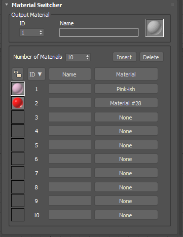

Interface
[material controls]
These buttons appear above the sort list controls. They are used to show information about the output material, control the amount of list items, and insert and delete materials.
Index Number (ID)
Displays the index number of the selected material.
Name Field
This field displays the user-defined name of the selected output material.
Number of Materials
Click to control the number of materials available in the list.
Insert
Click to insert a new entry into the list. The entry inserted will appear above the selected material in the material switcher, the entry will be empty until you select a material to occupy it. If the selection is locked, the inserted item will appear above where the secondary selection is made. The secondary selection is identified with the blue square.
Delete
Click to delete the selected entry from the list. Deleting a material from Material Switcher will delete it's connection to Material Switcher (it will not delete the material itself).
[sort list controls]
These buttons appear above four of the columns in the sub-materials list. They are used to organize materials.
Lock Header
Click to toggle the ability to switch materials by selecting material icons.
ID Header
Click to set the output material to the index (ID) number shown (descending or ascending).
Name Header
Click to sort the materials by user-defined names.
Material Header
Click to sort the materials by material type.
[list of materials]
Each material has a single entry in this list. The rollout can display 9999 materials, you can scroll the list using the scrollbar at the right.
Each material in the list has the following controls:
Small sample sphere
The small sample sphere is a "mini-preview" of the material. Click it to select this material. You must select a material before you delete it.
ID
Shows the index number assigned to this material.
Name
Lets you enter a custom name for the material.
Material/None button
By default, each list item will be set to None, indicating you can add a new material to the list from the Material/Map browser.
Once you have entered a material into the list, its name will appear here. Click the material to view or edit its attributes.
