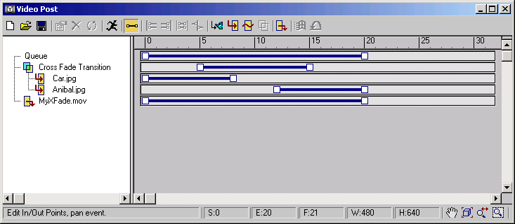

Set up a simple cross fade between two images:
- Choose Rendering
Video Post.
- Click
(Add Image Input Event), and then click Files.
Choose your first image and click Open and then click OK to close the Add Image Input Event dialog.
- Click
(Add Image Input Event) again, and then click Files.
Choose your second image and click Open and then click OK to close the Add Image Input Event dialog.
- Click
(Add Image Output Event), and then click Files.
- Set the output file format to MOV File and enter a filename like
MyXFade.
Click Save when you've set the name and format
- Click OK to accept the default setting on the Compression Settings dialog.
Then click OK to close the Add Image Output Event dialog.
- Select the first Image Input Event and then hold down the
Ctrl key while selecting the second Image Input Event.
Both events will highlight in gold.
- Click
(Add Image Layer Event), and choose Cross Fade Transition from the list of compositors and transitions.
Click OK to close the Add Image Layer Event dialog. Notice how the Image Layer Event becomes the parent of the two Image Input Events.
- Click
(Zoom Extents) to view the entire set of tracks.
- On the Queue track bar, click and drag the right-hand end of the range-bar to frame 20.
This adjusts all the tracks.
- Select the Cross Fade Transition event and drag the left-hand end of the range-bar to frame 5 and then drag the right-hand end of the range-bar to frame 15.
This sets the period in time when the cross fade occurs.
- Select the track for the first Image Input Event and the right-hand end of the range-bar to frame 8.
By setting the end to frame 8 instead of 5, you'll have three frames during which the first image will fade to black.
- Select the track for the second Image Input Event and the left-hand end of the range-bar to frame 12.
Similarly, setting this end to frame 12 ensures that the second image will fade in over three frames and display in full color for the last five frame of the transition.
- Click
(Execute Sequence).
- Click Render on the Execute Video Post dialog.

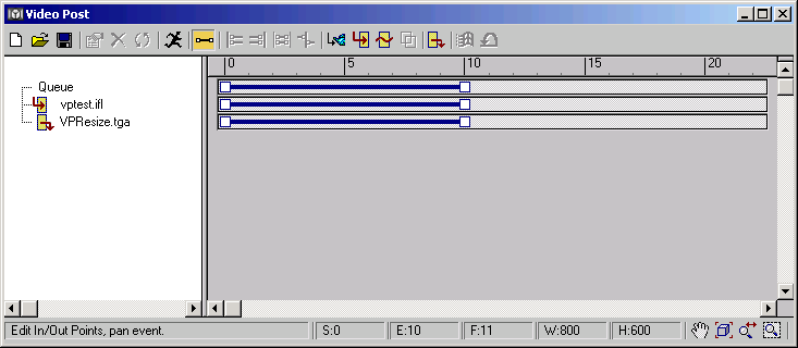

Example: Resize a series of images:
- Use the IFL Manager Utility to create an IFL file containing the sequentially number image files you want to resize.
- Choose Rendering
Video Post.
- Click
Choose the IFL file you created at step 1 and then click Open to close the selection dialog.
- Click OK to close the Add Input Image Event dialog.
- Click
- Set the output file format for the new set of still images to TGA and enter a filename like
MyResize.
- Click OK to accept the default setting on the Targa Image Control dialog.
- Click
(Execute Sequence).
- On the Execute Video Post dialog, set the new output resolution you want for the images and then click Render.
When the rendering is complete, you will have a new series of resized images that have a name prefix of MyResize. So, if there were ten images listed in the IFL file, there will be ten new images named MyResize0000.tga through MyResize0009.tga stored in your image folder.

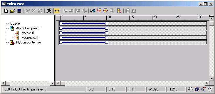

Example: Composite two image sequences:
- Use the IFL Manager Utility to create an IFL file for each set of images sequences you want to composite.
- Choose Rendering
Video Post.
- Click
Choose your first IFL file and click Open and then click OK to close the Add Image Input Event dialog.
- Click
Choose your second IFL file and click Open and then click OK to close the Add Image Input Event dialog.
- Click
MyComposite.
- Click
Alpha Compositor from the list of compositors and transitions.
- Click
(Execute Sequence).
Compositing two sets of images together is one of the “workhorse” operations of Video Post. This is commonly done when a project is nearing completion and it lets you combine all the images your artists have been rendering.

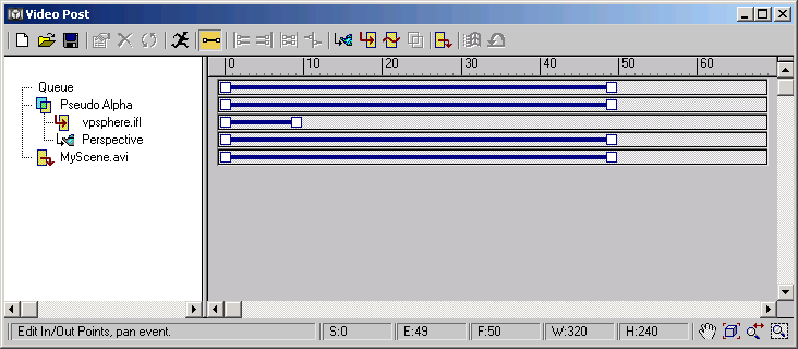

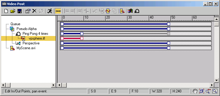

Example: Render a scene over an image sequence or an animation:
- Use the IFL Manager Utility to create an IFL file for the set of images that will be the background for your current scene.
- Choose Rendering
Video Post.
- Click
Choose your IFL file or animation and click Open and then click OK to close the Add Image Input Event dialog.

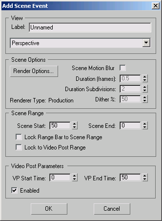

Click
Add Scene Event and set the view to Perspective or a Camera you have in the scene.
Click OK to close the Add Scene Event dialog.
- Click
- Set the output file format to AVI File and enter a filename like
MyScene.
- Select a codec from the Video Compression dialog and click OK.
Ctrl key while selecting the Scene Event.
- Click
Pseudo Alpha from the list of compositors and transitions.
- Click
(Execute Sequence).
Notice that the Image Input Event in this example is only ten frames long. Normally, you'd choose a set of background images that equals the number of frames in your scene. When this sequence is executed, as is, the images in the IFL file will only appear for the first ten frames and then disappear.
- Select the Image Input Event just under the Pseudo Alpha layer event.
- Add a
Loop Event, and set the number of times to
4.
The Image Input Event becomes further nested in the queue. If you want, you can use the default Loop setting or change it to Ping Pong then click OK to close the Add Loop Event dialog.
- Click
(Execute Sequence) again and render the scene.

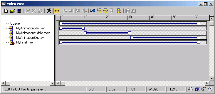

Join two animations end to end:
- Choose Rendering
Video Post.
- Click
Choose your first animation file and click Open and then click OK to close the Add Image Input Event dialog.
- Click
Choose the next animation file and click Open and then click OK to close the Add Image Input Event dialog.
- Repeat the last step for any other animations that need to be joined.
- Click
MyFinal.
- Click
(Abut Selected).
- Repeat the last two step with subsequent Image Input Events.
- Click
- Select the Image Output Event and drag the right end of the range-bar to match the total number of frames in the queue.
- Click
(Execute Sequence).
If you're working in a production environment, you probably do not work on an entire animation by yourself. Instead, you might work on one part while other artists are working on other parts. At the end of the project, everyone's animations need to be joined together.

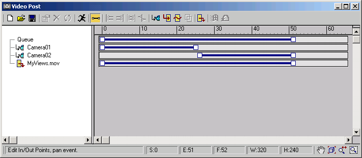

Switch between views:
- In the Perspective viewport, create a Box with a length of 15, a width of 30 and a height of 15.
- In the Top viewport, create two Target Cameras pointing at the box from different angles.
- Click or right-click the Point-Of-View (POV) viewport label in the Left viewport. From the
POV viewport label menu, choose Views
Camera01.
- Click or right-click the POV viewport label in the Perspective viewport. From the
Camera02.
- Choose Rendering
Video Post.
- Click
(Add Scene Event), and set the view to Camera01.
- Click
(Add Scene Event) again, and set the view to Camera02.
- Select the first Scene Event and then hold down the
Ctrl key while selecting the second Scene Event.
- Click
(Abut Selected).
- Click in an empty part of the queue to deselect the two Scene Events.
- Click
MyViews.
- Click
(Execute Sequence).
It's not often that a final scene shows views from only one viewpoint. Either the camera moves or there are multiple cameras from which images are rendered. This sequence shows you how to switch from one camera view to another.

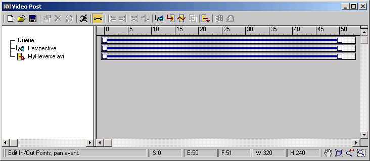

Render a scene in reverse:
- Choose Rendering
Video Post.
- Click
(Add Scene Event), and set the view to Perspective or a camera in the scene.
- In the Scene Range group, turn off Lock To Video Post Range and set the Scene Start value to the last frame of animation.
- Turn off Lock Range Bar To Scene Range and set the Scene End value to 0.
- Click
MyReverse.
- Click
(Execute Sequence).
It's not commonly done but when you need to render a scene in reverse you could spend hours trying to accomplish it. Video Post makes it easy.
