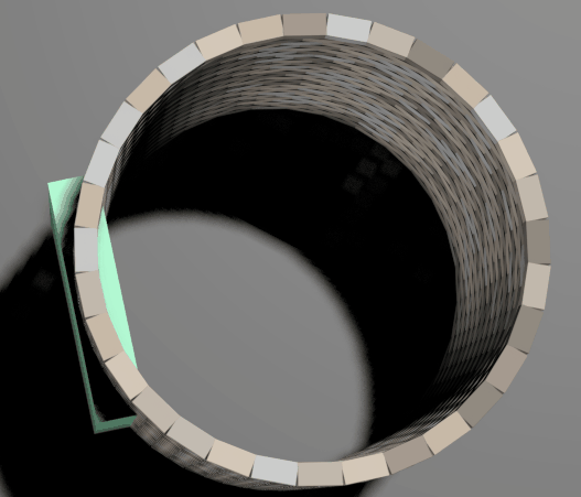

Pick Cull Object
When a cull object is selected, clones are removed if they are outside of the volume of the selected polygon object.
In the following example, the rectangle is the cull object. All bricks from the tower are removed, except the bricks that are inside the volume of the rectangle.
Note: For predictable results, ensure that the cull object does not have open holes or gaps.
Note: Right click Pick Cull Object and select Clear Cull Object to reset the cull object.

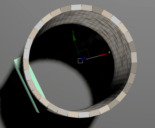

Invert
When selected, clones are removed if they are inside of the volume of the selected polygon object.
In the following example, this parameter has been used to create an opening in a brick tower. A rectangle, the cull object, has been positioned so it fully encloses the bricks. When the rectangle is hidden, we can see that the bricks enclosed within the volume of the rectangle have been removed from the tower.
