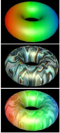

Shellac material mixes two materials by superimposing one over the other. Colors in the superimposed material, called the "shellac" material, are added to colors in the base material. A Shellac Color Blend parameter controls the amount of color mixing.
  • Material/Map Browser > Materials > General > Shellac
  • Note: The material appears in the Material/Map Browser only if the active renderer supports it.
Top: Base material
Middle: Shellac material
Bottom: Materials combined with a shellac color blend value of 50%

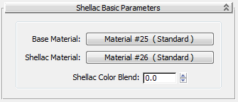

Interface
Base Material
Click to choose or edit the Base sub-material. By default, the Base material is a Standard material with Blinn shading.
Shellac Material
Click to choose or edit the Shellac material. By default, the Shellac material is a Standard material with Blinn shading.
Shellac Color Blend
Controls the amount of color mixing. At 0.0, the Shellac material has no effect. Increasing the Shellac Color Blend value increases the amount of Shellac material color blended into the Base material color. There is no upper limit on this parameter. Large values "overload" the Shellac material colors. Default=0.0.
