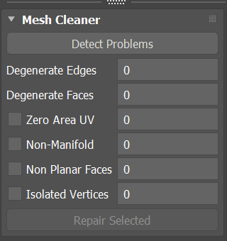

Mesh Cleaner rollout
- Detect Problems button
- Click to detect problems in the targeted mesh.
- Degenerate Edges
- Displays the number of degenerate edges detected.
- Degenerate Faces
- Displays the number of degenerate faces detected.
- Zero Area UV
- When enabled, attempts to detect any UV coordinates as part of UV spaces that are too small compared to the size of the mesh volume. When repaired, the detected UV coordinates are detached from those unaffected to scale up the UV area.
- Non-Manifold
- When enabled, attempts to detect any non-manifold sections that prevent a watertight mesh.
- Non-Planar Faces
- When enabled, attempts to detect any non-planar faces through triangulation. When repaired, the detected non-planar faces have their UVs shifted to make them planar.
- Isolated Vertices
- When enabled, attempts to detect any exploded points or isolated vertices that do not hold any mesh data. When repaired, the isolated vertices are deleted.
- Repair Selected button
- Click to repair all selected mesh problems.
