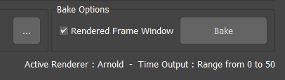

to open the Bake to Texture dialog.
The active renderer and time output range is shown on the bottom right of the Bake to Texture window.

- Click Bake.
