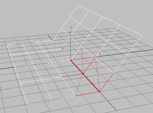

In the illustration, the cloth consists of two planes, and the edges of the front half of the join between the planes have been selected.
Two planes of cloth to weld
Welding normals with Don’t Weld Sel Edges on (the default)
At the rear half of the join, normals on either plane are matched within the Threshold distance.
Welding normals with Don’t Weld Sel Edges off
Normals are matched all along the join.
Welding vertices with Don’t Weld Sel Edges on (the default)
Welding vertices joins the plane geometry, but only at the rear half of the join are normals matched.
Vertices are joined and normals are matched all along the join.
