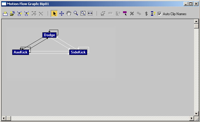

Motion Flow is a tool that graphically arranges clips (motion files) so that animation transitions smoothly from one clip to the next. You can use a Motion Flow graph to set up a series of clips with transitions between them. The biped then performs the series of motions in sequence.
Motion Flow graph with transitions between motion files

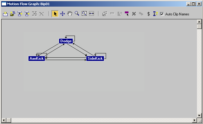

You can also create a network of clips on the graph, where each clip has a transition to two or more clips. With this type of graph, you can tell character studio to generate the actual motion sequence for you based on random selection.
Multiple transitions from each clip
