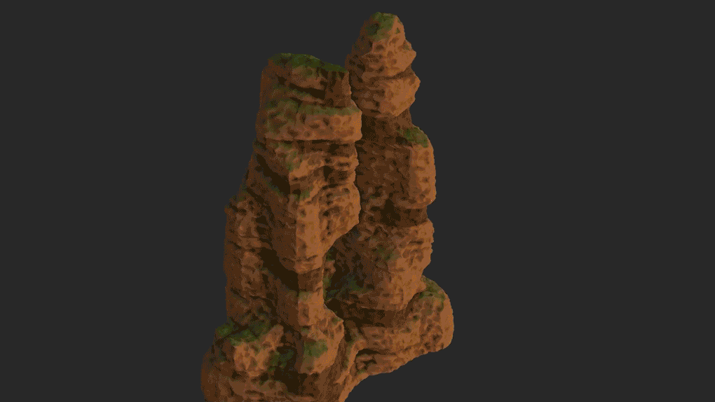

DCM modifier in 3ds Max has new preset options for turning mesh data into a selection and passing it up the modifer stack, alongside new ways to change channel data.
Model and setup by Changsoo Eun. Animation displays Select Top verts updating as the model rotates, then uses the Array Modifier to distribute grass onto those selected verts.
