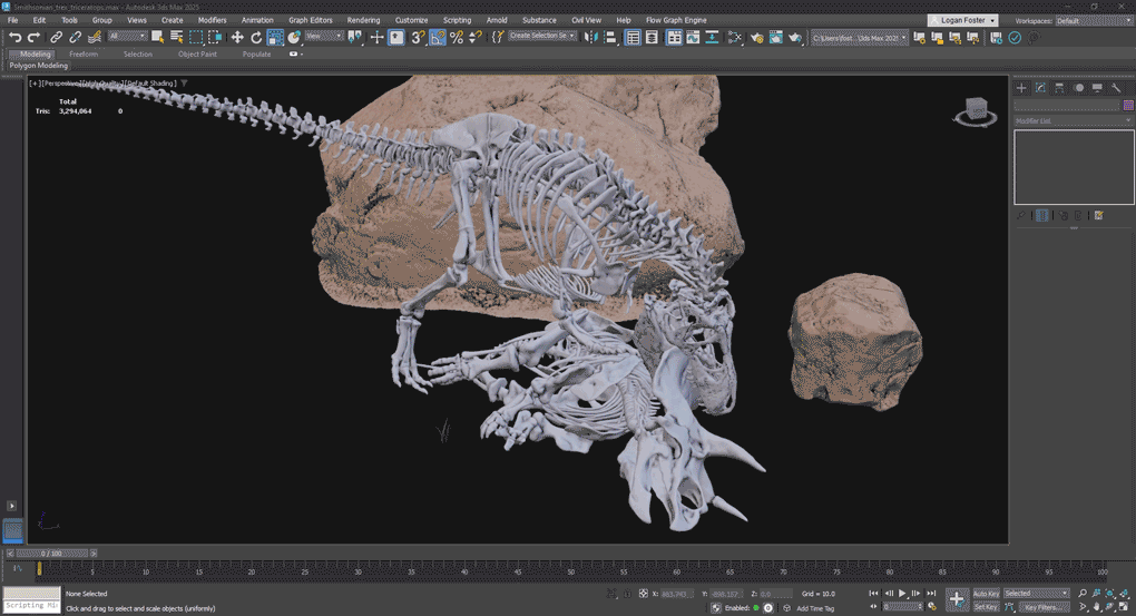

Tyrannosaurus and Triceratops by The Smithsonian Institution
