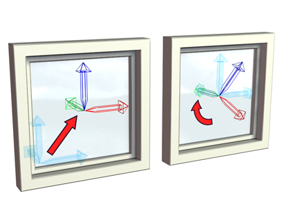

Affecting Pivot Only
When Affect Pivot Only is on, move and rotate transforms are applied only to the pivot of a selected object.
- Moving or rotating the pivot does not affect the object or its children.
- Scaling the pivot scales the object from the pivot center, but its children are unaffected.
Affect Pivot Only transforms the pivot without moving the object.

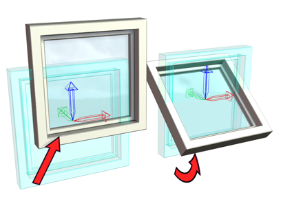

Affecting Object Only
When Affect Object Only is on, transforms are applied only to selected objects. Pivots are not affected.
Moving, rotating, or scaling the object does not affect the pivot or its children.
Affect Object Only transforms the object without moving the pivot.

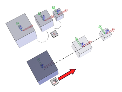

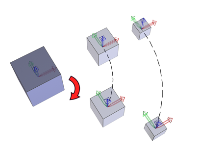

Affecting Hierarchy Only
When Affect Hierarchy Only is on, rotate and scale transforms are applied only to the links between objects and their children.
- Scaling or rotating an object affects the link offsets of all its descendents without affecting the geometry of the object or its descendents. The descendents shift position because of the scaled or rotated links.
Use this technique to adjust the offset relationship between linked objects.
Use this technique to adjust the offset relationship between linked objects and for adjusting bones to match geometry.
After a hierarchy is created, you can scale the position of the children without changing the individual objects’ dimensions.
Rotating the hierarchy does not affect the individual objects’ orientation.
