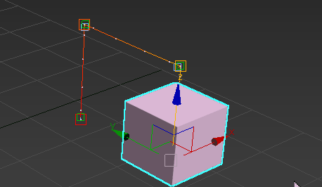

To view the motion path of a selected animated object, do one of the following:
- Right-click an animated object and, from the Quad menu, enable Show Motion Paths.
Showing a Motion Path on a cube animated with a Noise Position controller
Tip: When a motion path or animated object is selected, you can right-click in the viewport and use the Tools 2 quadrant of the Quad menu to access various motion path-related options. - Enable the Motion Path checkbox in the Display Properties group on the General panel of the Object Properties dialog.

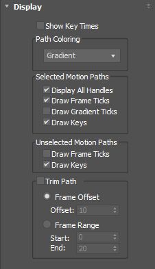

Display rollout
- Show Key Times
- Displays the specific frame number beside each key in the viewport.
- Path Coloring
- Sets how the motion path is colored.
Select:
- Gradient to shade the motion path using a gradient. Yellow to red is the default.
- Object Color to draw the motion path according to the color of its parent object.
- Uniform to draw the motion path in a uniform color. Red is the default.
- Velocity to shade the motion path according to its relative velocity. Red shows the highest velocity while blue shows the lowest as default.
You can change the various default colors for displaying motion paths in the Custom User Interface dialog under .
Selected Motion Paths group
- Display All Handles
- Display tangents handles for all keys, including unselected ones.
- Draw Frame Ticks
- Draws white ticks to show the position of the motion path at specific frames.
- Draw Gradient Ticks
- Draws gradient colored ticks to show the position of the motion path at specific frames.
- Draw Keys
- Draws keys on selected motion paths.
Unselected Motion Paths group
- Draw Frame Ticks
- Draws white ticks to show the position of the motion path at specific frames on unselected motion paths.
- Draw Keys
- Draws keys on unselected motion paths.
Trim Path group
- Trim Path toggle
- When enabled, trims the display of the motion path.
- Frame Offset
- Trims the motion path by displaying only a specified number of frames before and after the current frame. For example, enter 100 to display only the portion 100 frames before and 100 frames after the current position on the time slider.
- Frame Range
- Sets the range of frames to be displayed.

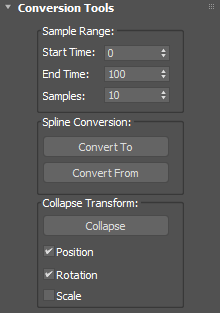

Conversion Tools rollout
Sample Range group
- Start Time/End Time
- Specifies the interval for the conversion. When converting from position keyframes to a spline object, this is the time interval for which the motion path will be sampled. If you're converting from a spline object to position keys, this is the interval over which the new keys will be placed.
- Samples
- Sets the number of samples for the conversion. When converting in either direction, the source is sampled at regular intervals, and keys or control points are created on the target object.
Spline Conversion group
- Convert To/Convert From
- Converts keyframe position tracks to and from spline objects. This enables you to create a spline motion path for an object and then convert that spline to keyframes for that object's position track in order to do various keyframe-specific functions (such as applying constant velocity to the keys and normalizing the time). Or, you can convert an object's position keyframes into a spline object.
Tip: Convert To and Convert From can be used to move an object along a path without using a path constraint.
Collapse Transform group
Generates keys based on the current transformation of the selected object. You can apply this for any type of transform controller assigned to an object, but the main purpose of this function is to "collapse" a parametric transform effect, such as one generated by a Path constraint, into standard, editable keys.
- Collapse
- Collapses the transform of the selected object.
- Position, Rotation, Scale
- Specifies which transforms you want to collapse.
You must choose at least one checkbox to activate the Collapse button.
