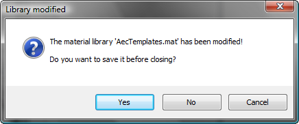

Tip: If the material is in the active View, you can also drag a wire from the material's output socket, then drop the material onto the library group. - In the Material/Map Browser, right-click the library file entry and choose Close Material Library.
3ds Max asks if you want to save changes to the library. Click Yes.
Note: You can also right-click the library file entry, select the library path and name, and select Save or Save As. When you select Save As, you can specify a new file name and also save as compatible with a previous version of 3ds Max, up to three previous versions.
