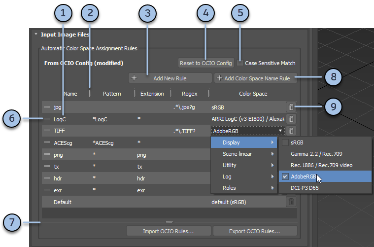

The OpenColorIO color-space assignment rules automatically assign an initial color space to input image files based on string patterns in their file names or paths. You can edit the rules to match the color spaces and file-naming conventions that you typically use. Image-based textures get converted from the assigned input space to the rendering space for shading calculations. When you specify an image to use as a texture in a scene, you can always set its color space manually if the automatically-assigned color space is incorrect.
- Basic rules use glob syntax to match a pattern in a file's full path and name and/or a pattern in its extension. They are easy to understand and create, but lack flexibility — for example, two separate rules are required to match both the .jpg and .jpeg extensions.
- Regex rules use regular expressions to match a pattern anywhere in a file's full name including its path and extension. This allows for additional capabilities if you are familiar with regex.
- The Default rule cannot be moved or deleted but you can change the color space that it assigns. The Default rule is always applied last if no other rule matches. In 3ds Max's default config, it assigns images to the color space that has the "default" role, which is sRGB in that config.
- Double-click in a table cell to modify a rule's Name, Pattern, Extension, Regex string, or the Color Space that it assigns. A rule can be basic or regex-based but not both — if you set Pattern or Extension then the Regex column is automatically cleared and vice versa.
- Drag a vertical separator in the table's header to resize the columns.
- Click Add New Rule to add another row for a new rule to the top of the table.
- If the rules have been modified from those stored in the active OCIO config file, you can click Reset to OCIO Config to discard all modifications.
- Set Case Sensitive Match to control whether the Pattern and Regex strings are treated as case-sensitive when matching file names. The Extension string is not case-sensitive unless it contains glob tokens — for example, [e][x][r] matches "exr" but not "EXR".
- Drag one of the grippers at the left of a row to reorder the rules. The rules are tested in order from top to bottom. The first rule that matches a file is the rule that gets applied.
- Drag the horizontal bar at the bottom to resize the table.
- Click Add Color Space Name Rule to add a special rule named ColorSpaceNamePathSearch which replicates how image files were assigned to color spaces in OCIO v1. It assigns each texture file to the longest color-space name found anywhere in its file path and name. Note that matches are not case-sensitive.
- Click the trash-can icon to delete the corresponding rule.
A rule's name is used for identification only. It gets shown in the Select Bitmap Image File dialog and other places to indicate which rule was responsible for assigning a color space automatically. Each name must be unique.
Whenever the rules change, any existing textures whose color space was set to Automatic get re-assigned as appropriate. Textures whose color space was set manually do not change.
