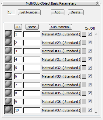

The controls for a Multi/Sub-Object material are essentially a list of the sub-materials it contains.

Interface
Number
This field displays the number of sub-materials contained in the Multi/Sub-Object material.
Set Number
Sets the number of sub-materials make up the material. At the Multi/Sub-Object material level, the sample slot's sample object shows a patchwork of the sub-materials. (When you edit a sub-material, the sample slot display depends on the setting of the Simple Multi Display Below Top Level toggle on the Material Editor Options dialog.)
Reducing the number of sub-materials removes sub-materials from the end of the list. You can undo Set Number when you have used it to delete materials.
Add
Click to add a new sub-material to the list. By default, the new sub-material's ID number is one greater than the highest material ID already in use.
Delete
Click to delete the currently chosen sub-material from the list. You can undo deleting a sub-material.
[sort list controls]
These buttons appear above three of the columns in the sub-materials list.
ID
Click to sort the list so it begins with the sub-material that has the lowest material ID, and ends with the sub-material that has the highest material ID.
Name
Click to sort the list by the names you have entered in the Name column.
Sub-Material
Click to sort the list by the sub-material names that appear on the Sub-Material buttons.
[list of sub-materials]
Each sub-material has a single entry in this list. The rollout displays up to 10 sub-materials at a time. If the Multi/Sub-Object material contains more than 10 sub-materials, you can scroll the list using the scrollbar at the right.
Each sub-material in the list has the following controls:
Small sample sphere
The small sample sphere is a "mini-preview" of the sub-material. Click it to select this sub-material. You must select a sub-material before you delete it.
ID
Shows the ID number assigned to this sub-material. You can edit this field to change the ID number. If you assign two sub-materials the same ID, a warning message appears at the top of the rollout.
When the Multi/Sub-Object material is applied to an object, faces in the object assigned the same material ID number render with this sub-material.
You can click Sort by ID to sort the sub-material list by this value, from lowest to highest.
Note: Sometimes the Sub-Material button shows a material number. This is not the sub-material ID.
Name
Lets you enter a custom name for the material. A sub-material name appears in the Name field when you're at the level of the sub-material. It also appears in the Browser and the Navigator.
Sub-Material button
Click the sub-material button to create or edit one of the sub-materials. Each of the sub-materials is a complete material in its own right, with as many maps and levels as you want.
By default, each sub-material is a Standard material with Blinn shading.
Color swatch
Click the color swatch to the right of the Sub-Material button to display the Color Selector and choose a diffuse color for the sub-material.
On/Off toggle
Turns the sub-material on or off. When a sub-material is off, it appears black in the sample slot and on objects in the scene. Default=on.
