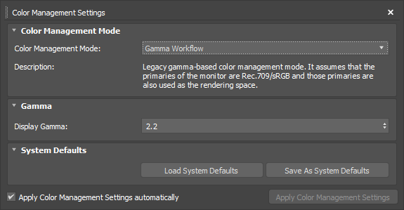

Gamma Workflow
The legacy gamma-based color management mode. Colors are treated in the same way as in versions of 3ds Max prior to 2024. Gamma encoding is removed from color inputs, and then re-applied for display and output after the lighting calculations have been performed. This mode assumes that the primaries of the monitor are Rec.709/sRGB and those primaries are also used for rendering. See "Gamma Workflow options" below.

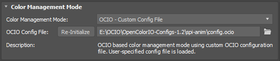

OCIO - Custom Config File
Similar to OCIO - 3ds Max Default but with the option to specify a custom configuration file, such as one that has been especially developed for your project or studio. See "OCIO options" below.
OCIO - Environment Variable
Uses the configuration file specified by the OCIO environment variable. This is an environment variable that can be set to the path and name of a configuration file to be used by various OCIO-enabled applications in order to ensure consistency across a content pipeline. See "OCIO options" below.
Note: If the OCIO environment variable has not been set to the full path of a valid OCIO config file on your system, the Description includes the message "No config file is loaded..." and colors will not be managed.

OCIO Config File
Specifies the absolute path and name of an OCIO configuration file (.ocio) or archive file (.ocioz) that defines the available color spaces, transforms, and other options. This file must be available on all machines that are used to edit and render the scene.
With OCIO - Environment Variable, this text box displays the resolved path of the OCIO environment variable and cannot be edited.
Note: If there are any issues loading the specified config file, messages appear on the Color Management tab of the Render Message Window.

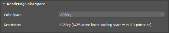

Rendering Color Space
Color Space
The color space in which shading calculations are performed. Color inputs are transformed into this space for rendering, and rendered images are transformed from this space for viewing.
The following rendering spaces are available in 3ds Max's default config file — all of them are scene-linear (that is, values are directly proportional to the amount of light energy in the scene), which is necessary to be compatible with modern renderers. If you are using a custom config, different spaces may be available.
  • ACEScg: ACES scene-linear working space using the AP1 primary chromaticities for red, green, and blue. This color space is part of the Academy Color Encoding System, and is designed to be appropriate for computer graphic operations like compositing and 3D rendering. It encompasses both the Rec-2020 gamut and the DCI-P3 gamut for a range of white points.
  • scene-linear Rec.709-sRGB: A working space that uses the same primaries as sRGB and HDTV (Rec. 709), but with scene-linear color values. This is a common rendering space but it has a very limited gamut, meaning that it can represent only a relatively small range of colors when compared to digital cinema or film. For this reason it is often desirable to use a rendering space with a wider gamut, especially when rendering 3D elements that will be composited together with footage from digital cameras or scanned film plates.
  • scene-linear DCI-P3 D65: A working space that uses the same primaries as a DCI/SMPTE "P3" reference projector, but with scene-linear color values and the D65 white point. The advantage of using this color space is that it can represent all the colors available on a modern projector. In addition, there is little risk of producing colors that are out-of-gamut for a projector, which might cause unpleasant surprises if the content is ever viewed in the future on a device with a wider gamut.
  • scene-linear Rec.2020: A working space that uses the same primaries as UHDTV and HDR TV, but with scene-linear color values. The standard for HDR TV is actually Rec.2100, but it uses the same primaries. This space can represent any color that is theoretically possible for UHDTV or HDR TV, but since the Rec.2020 primaries are on the spectral locus there are no actual displays that are able to accurately show the full gamut of colors.
Note: Any literal color values (including solid colors and other color parameters) in the scene are assumed to be in the rendering space, but they are not converted when you change the rendering space in a scene that has already been set up. This can result in final colors that were not intended, so it's best to set up color management at the start of a new scene or project.

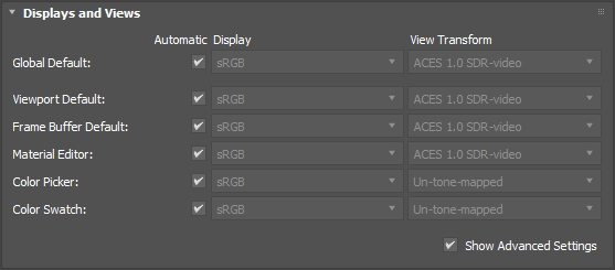

Displays and Views
Controls how the color values of the rendering space values appear in various windows and UI elements. Use Global Default to control all elements at once, or turn on Show Advanced Settings to set options for various elements individually.
You can control the following windows and UI elements independently:
  • Global Default: Controls any of the individual elements (available when Show Advanced Settings is on) that are set to Automatic. Note that Color Picker and Color Swatch have a different default for View Transform.
  • Viewport Default: The default settings for the viewports. You can change the settings for a specific viewport on the Color Management tab of the Active Viewport Settings dialog box available from the Shading viewport label menu. Note that the Color Management tab is available on the Active Viewport Settings dialog box only when using an OCIO color management mode.
  • Frame Buffer Default: The default settings for the Rendered Frame Window. You can change these on-the-fly on the Rendered Frame Window's toolbar.
  • Material Editor: The settings for thumbnails in the Material Editor.
  • Color Picker: The settings used by the Color Selector dialog box.
  • Color Swatch: The settings used by color swatches. Note that some swatches are not color-managed, such as object color.
For each element, you can set the following controls:
Automatic
Uses the Global Default settings or in the case of Global Default itself, uses the default choices from the OCIO configuration file. Turn Automatic off to set Display and View options manually.
Display
Select the option that best matches the calibration state of your display. The choices available in 3ds Max's default config file are listed below. If you are using a custom config, your choices may be different.
  • sRGB: sRGB primaries and gamma.
  • Gamma 2.2/Rec. 709: Rec. 709/sRGB primaries and a gamma of 2.2.
  • Rec. 1886/Rec. 709: Rec. 709 video.
  • AdobeRGB: Adobe RGB (1998) color space.
  • DCI-P3 D65: digital cinema "P3" projector with an artistic white point of D65.
If you are using a custom config, select Display before selecting View Transform because the available views might depend on the display. This is not the case for 3ds Max's default config file, however.
View Transform
Select the view transform (tone map) to convert the scene-referred colors from the rendering space to display-referred colors for previewing. For normal previewing, choose the same transform that will be used for the final image. The choices available in 3ds Max's default config file are listed below. If you are using a custom config, your choices may be different.
  • ACES 1.0 SDR-video: Applies the ACES tone map for standard-dynamic-range video. This uses an S-shaped curve to roll off the highlights leaving room near 1 for very bright values. It also boosts the saturation and contrast to give the sort of response that's familiar from digital cinema and photography.
  • Un-tone-mapped: Displays the rendering-space values directly on the display device with no tone-mapping. Values above 1.0 are simply clipped before being encoded for display. This is how many image-editing applications display images.
  • Log: Applies a logarithmic tone map for diagnostic purposes. This is useful for showing a wide range of colors from very dark to very bright at the same time.
  • Raw: Shows the untransformed rendering-space values for diagnostic purposes. No gamma is applied for display.

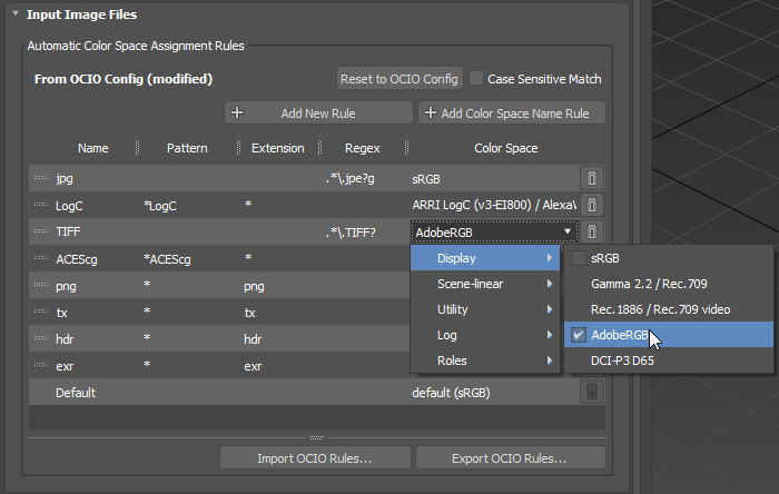

Input Image Files
Automatic Color Space Assignment Rules
The table shows the rules that automatically assign color spaces to input images based on file name and path. Image-based textures are converted from the assigned input space to the rendering space for shading calculations. Note that when you specify an image to use as a texture in a scene, you can always change the automatically-assigned color space if it is incorrect.
The initial rules are defined in the configuration file, but you can edit them here to match the color spaces and file-naming conventions that you typically use. For the full details, see To Edit Color-space Assignment Rules.
  • Double-click in a table cell to change a rule's name, file name pattern, extension, regex pattern, or the color space that it assigns. Note that a rule can be based either on a file's full path and extension using glob syntax, or using regular expressions (regex), but not both. If you modify Pattern or Extension, the Regex column gets cleared automatically and vice versa.
  • Click Add New Rule to add a row for a new rule at the top of the list.
  • Click Add Color Space Name Rule to add a special rule named ColorSpaceNamePathSearch which replicates how image files were assigned to color spaces in OCIO v1. It assigns each texture file to the longest color-space name found anywhere in its file path and name. Note that matches are not case-sensitive.
  • Drag one of the grippers at the left of a row to reorder the rules. The rules are tested in order from top to bottom. The first rule that matches a file is the rule that gets applied. Note that the Default rule cannot be moved and is always applied last if no other rule matches. In 3ds Max's default config, it assigns images to the color space that has the "default" role, which is sRGB in that config.
  • Click the trash-can icon at the right of a rule to delete it. You cannot delete the Default rule.
  • If the rules have been modified, the Reset to OCIO Config button appears. Click it if you want to restore the rules that are set in the selected config file.
Whenever the rules change, any existing textures whose color space was set to Automatic get re-assigned as appropriate. Textures whose color space was set manually do not change.
There is only one option for the Gamma Workflow mode.
Note: LUTs are no longer supported (except through custom OCIO configurations).
Display Gamma
Enter the gamma value for compensating between display code values and display luminance. The default gamma of 2.2 closely approximates the sRGB gamma curve.
