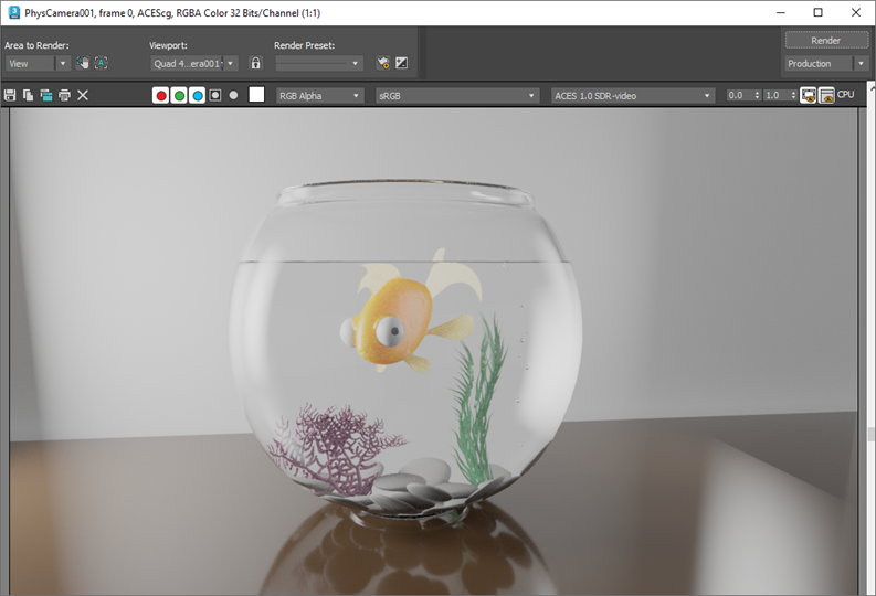

The Rendered Frame Window Title Bar
The title bar of the Rendered Frame Window includes this information:
- Viewport name
- Frame number
- The display gamma value (when using Gamma Workflow color management mode) or view transform (when using an OCIO color management mode).
- Image type and color depth
For example, a full-color image with an alpha channel will show “RGBA Color 16 Bits/Channel”; a bitmap with a limited color depth might show “Indexed Color 8 Bits/Pixel,” and so on.
- Image aspect ratio
Rendering Controls
These controls provide access to rendering settings such as presets and the viewport to render, as well as the Render command. To toggle display of these controls, click the Toggle UI button at the right end of the Rendered Frame Window toolbar.
