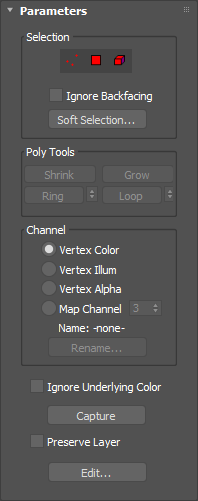

Parameter rollout
Selection group
The controls in this group are identical to the selection controls found in the Selection group of the Paintbox rollout.
Poly Tools group
- Shrink
- Reduces the sub-object selection area by deselecting the outermost sub-objects. If the selection size can no longer be reduced, the remaining sub-objects are deselected.
- Grow
- Expands the selection area outward in all available directions. For this function, a border is considered to be an edge selection.
- Ring
- Expands an edge selection by selecting all edges parallel to the selected edges.
- Loop
- Selects a loop or loops based on the current sub-object selection.
Tip: You can select a loop quickly by selecting a sub-object and the Shift+clicking another object at the same level in the same loop.
Channel group
These controls specify which channel type the vertex paint layer will affect, and which map channel number you'll paint on.
- Vertex Color Choose this to paint on a vertex color layer.
- Vertex Illum Choose this to paint on a vertex illumination layer.
- Vertex Alpha Choose this to paint on a vertex transparency layer.
Map Channel Choose this to paint on a specifically named or numbered map channel.
- Map channel spinner
Specifies the channel number. Available only when Map Channel is chosen.
- Name
If a channel has a name defined it will appear here. Channels can be named using the Channel Info Utility.
- Ignore Underlying Color
When turned on, VertexPaint ignores whatever vertex colors it receives from below it on the stack. As a result, you will see the layer's raw colors on an otherwise white object. The blend mode has no effect (it behaves like Normal mode) because the base color is considered transparent, so the layer is not blended with anything.
The purpose of this toggle is to isolate a layer from the colors below, to help the user visualize the layer's raw data. The layer is not completed isolated when this is on, because layers above it can still affect the result. The user needs to disable those layers or turn off Show End Result to see the current layer in complete isolation.
The Ignore Base Color toggle should only be needed when the object at the bottom of the stack already has some vertex colors baked in. In other cases, you can just disable the paint layers or whichever modifiers are adding vertex colors to the object. In that case, the active paint layer would not receive any vertex colors from below itself on the stack. As a result, it treats all base color as transparent and the layer colors are displayed in the raw (not blended with anything).
Note: Per-vertex layer opacity is not passed up the stack. A paint layer modifier makes a yes/no decision about whether an object below it has vertex colors or not, and will subsequently treat all base colors as transparent or all as opaque. So if you paint even a single vertex using Edit Mesh, for example, the object is considered to have vertex colors, and a paint layer will blend its colors with the (predominantly white) mesh instead of treating the mesh as transparent. - Capture
VertexPaint copies the existing vertex colors it receives from layers below it on the stack and places it into the current layer for editing.Tip: When vertex colours have been placed into the current layer, enabling Ignore Underlying Color has no effect.
- Preserve Layer
When on, the modifier will not be deleted by any Condense To Single Layer operation. Since Condense To Single Layer performs two independent actions (creating a new baked-color modifier and then deleting existing modifiers), this option allows access to only the first part of the functionality when necessary. That is, you can bake colors into a new paint layer, without being forced to have the old modifiers deleted.

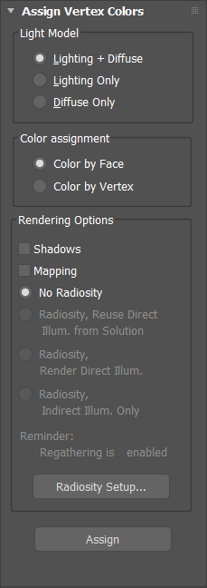

Assign Vertex Color rollout
This rollout gives you access to the same controls found in the Assign Vertex Colors utility. They let you take the scene lighting information and bake it into the vertex channel system.
