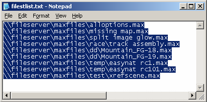

The second line of the batch file (dir) writes out the list of files to fileslist.txt (see the image below). This text file is used as the tasklist. In the cmdjob line, the –taskname parameter has the value 1, which means that each task will get its taskname from the first column of the taskfile. The %tp1 parameter specified after “3dsmax.exe” tells the cmdjob plugin to use task parameter 1 (column 1) from the tasklist as an argument to pass to 3dsmax.exe.
The tasklist text file

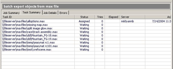

The Task Summary in the Queue Monitor.
