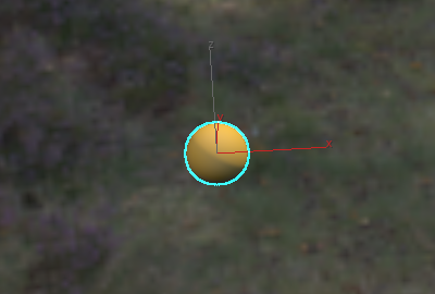

Create the center seed of the flower head
- Create a geosphere.
- In the Modify panel, set Radius to 2.0.
- Apply a PBR (Metal/Rough) material to the geosphere. See To Apply a Material to an Object.
- Adjust the
Base/Albedo color, so it appears yellow/orange.
This geosphere acts as the center seed in the daisy head.

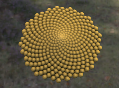

The
Phyllotaxis Distribution method can be used to create the spiral pattern found in the head of the flower.
- In the Modify panel, select Array from the Modifier List.
- In the
Distribution rollout, set the following:
- Distribution method: Phyllotaxis
- Count: 400
This parameter sets the number of seeds in the flower head.
- End Radius: 30
This parameter makes the flower head more compact.
- Radial Bias: -5.0
This parameter tightens the spacing of the seeds toward the center of the head.

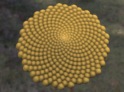

- In the
Array Modifier's
Transform rollout, set the following:
- Scale Method: Progressive
- Scale Link (
): On
- Scale
X: 140.0%
This step increases the scale of the clones progressively from the center outwards:

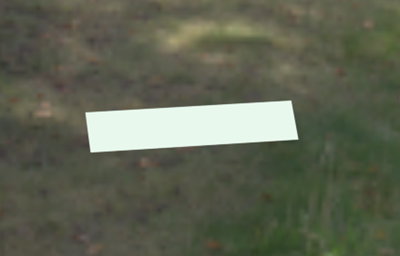

In this example, a plane is used to create a flower petal.
- Create a plane.
- In the Modify panel, adjust the plane's parameters:
- Length: 18.0
- Width: 90
- Length Segments: 2
- Width Segments: 4
- Apply a PBR (Metal/Rough) material to the plane. See To Apply a Material to an Object.
- Adjust the
Base/Albedo color, so it appears cream:

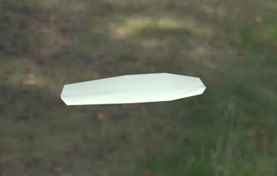

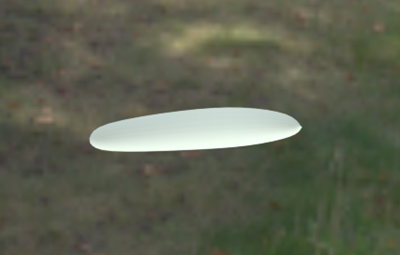

- Apply an Edit Poly modifier to the plane.
- Ensure the Edit Poly modifier is selected in the Modifier stack.
- In the Modifier stack, select
Vertex sub-object mode:
- Adjust vertices on your plane until you've created a shape like a petal:

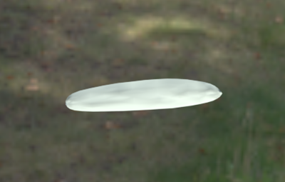

- Apply a MeshSmooth modifier to the plane.
- Ensure the MeshSmooth modifier is selected in the Modifier stack.
- In the Modify panel, set the following parameter in the
Subdivision Amount rollout:
- Iterations: 2
This step smooths out the edges of the petal:
- Iterations: 2

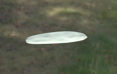

- Apply a Noise modifier to the plane.
- Ensure the Noise modifier is selected in Modifier stack.
- In the Modify panel, set the following parameters:
- Noise > Scale: 0.6
- Strength > Z: 0.9
Now, the petal is no longer completely smooth and appears more organic:
- Apply a Shell modifier to the plane.
- Ensure the
Shell modifier is selected in the Modifier stack:
- Outer Amount: 0.45
Now, the petal has some thickness:

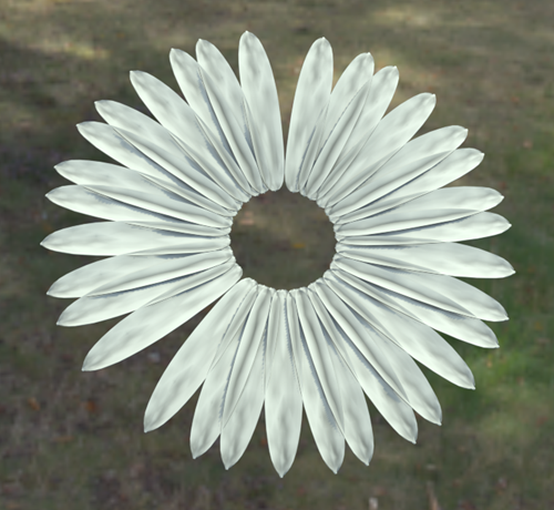

Create an array of petals
Let's use the Phyllotaxis Distribution method to quickly create a ring of petals.
- Select the plane (petal).
Array from the
Modifier List.
Note: Ensure that the Array modifier is at the top of the Modifier stack.

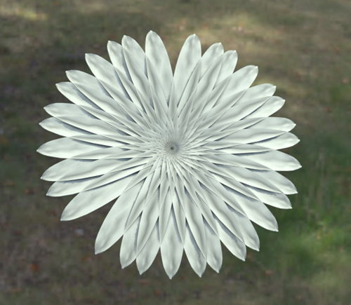

- In the
Array modifier
Distribution rollout, set the following parameters:
- Count: 32
The clones are placed in a phyllotactic spiral:

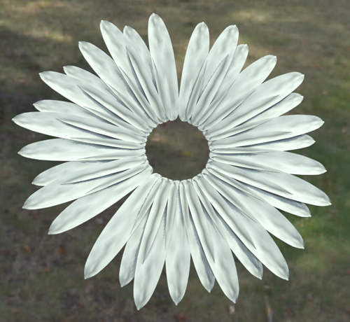

Let's continue to make adjustments in the Phyllotaxis rollout, so the petals form a ring.
- Set the following:
- Start Radius: 25.0
- End Radius: 25.0
These parameters push the petals out from the center to form a ring.
- Axial Bias: -10.0
This parameter adds depth to the petals.

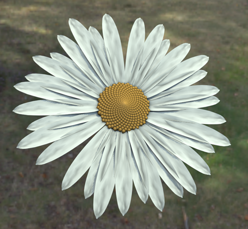

Final Adjustments: add realism to the array
Let's use some of the other Array Modifier rollouts to add additional details to the petals.
- In the
Array modifier
Transform rollout, set the following parameters:
- Scale Link (
): On
- Scale
X: 120.0%
Together, these parameters make the outer petals appear older and larger.
- In the
Array modifier
Randomization rollout, set the following parameters:
- Rotation Link (
): On
- Rotation X: 2.0
- Scale Link (
): On
- Scale X: 6.0
Together, these parameters create some randomizations in the petal sizes and positions, creating a more organic appearance.
- Rotation Link (
Make additional changes
To make the daisy appear more realistic, try the following:
- Create more than one petal shape and turn on
Array By Element, so all of the shapes are used in the array.
- Use a more accurate form for the center seed.
