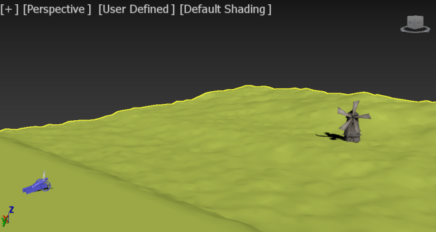

    The Perspective viewport should be active, indicated by a yellow border. If no border is visible, right-click anywhere within the viewport to activate it.

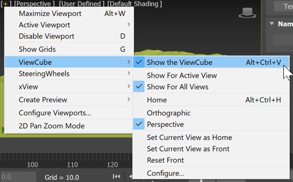

  2. If the ViewCube is not visible, click the Perspective viewport's General label—which looks like "[ + ]"—and choose ViewCube Show the ViewCube.

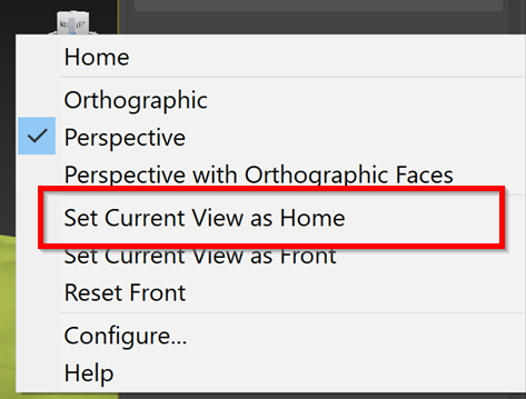

  3. In the Perspective viewport, right-click the ViewCube and choose Set Current View As Home.

  5. In the Perspective viewport, click the Home icon to the upper left of the ViewCube.
    The Perspective viewport returns to its initial viewpoint.
    Note: You can reset the Home viewpoint to the current view at any time by right-clicking the ViewCube and choosing Set Current View As Home.

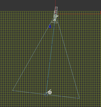

  3. In the Top viewport, click behind and slightly to the right of the cannon, then drag down to a point just left of the windmill (as shown in the following illustration). Don’t worry about the exact camera placement yet: You will adjust this later.

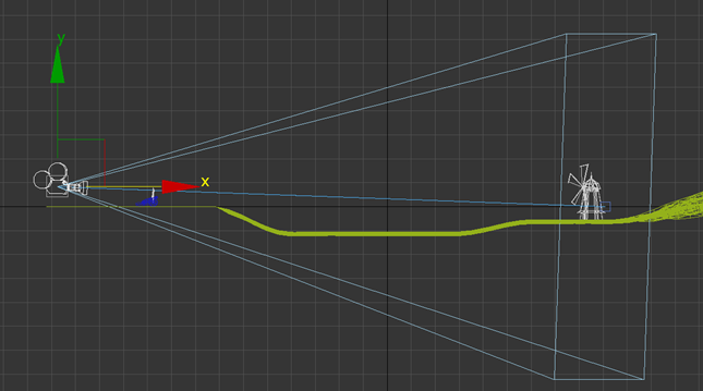

  6. Right-click the Left viewport, click the camera’s Y axis manipulator, and drag it slightly upward so you can see more of the horizon in the Camera001 viewport.
  7. If the cannon is not visible in the Camera001 viewport, then in the Top viewport drag the camera until the front of the cannon comes into view in the Camera001 viewport, as shown below.
