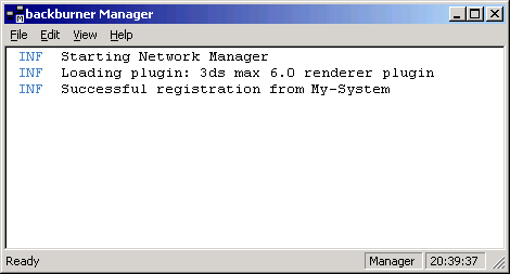

The application version of the network rendering Manager provides a graphical user interface for control and monitoring purposes. It runs as a foreground process on your desktop, and remains active unless specifically shut down. Its components include a menu bar, list window, and status bar.

List Window
This area of the Manager interface lists different types of information regarding the current status of the Manager. Depending on the selections made in the Logging Properties dialog, messages are displayed alerting the user, for example, to the following:
  • Connection and registration between the Manager and Server(s)
  • New job assignments
  • Which machine is the queue controller (that is, running Queue Monitor)
  • Frames assigned/rendered
  • Acknowledge packets sent between the Manager and Server(s)
  • Manager/Server(s) shutting down
  • Any rendering errors encountered
    This information can be filtered using the Logging Properties dialog.
