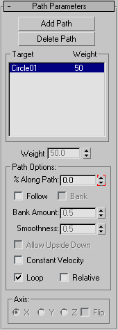

Path Parameters rollout
Once you assign a Path constraint, you can access its properties on the
Motion panel
Path Parameters rollout. On this rollout you can add or delete targets, assign weighting, and animate each target's weight value.
- Add Path
- Adds a new spline path that influences the constrained object.
- Delete path
- Removes a path from the target list. Once removing the path target, it will no longer influence the constrained object
- [path list]
- Shows the paths and their weights.
- Weight
- Assigns and animates weight values for each target.
