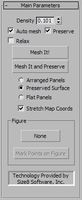

The Main Parameters rollout is the first rollout you see on the Modify panel once you apply the Garment Maker modifier.
This rollout comprises mostly controls to create and adjust the mesh. The remaining rollouts are available at the sub-object levels.

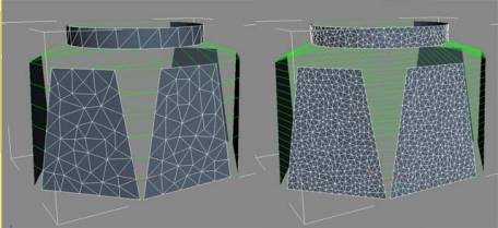

- Density
- Adjusts the relative density of the mesh (in other words, the number of triangles per unit area). Possible values range between 0.01 and 10.0. A value of 10.0 creates a very dense mesh, while 0.01 creates a comparatively low-resolution mesh.
For best results, use the lowest possible density to achieve the desired result. This speeds up simulation time and overall performance.
Left: Density=0.5
Right: Density=1.5
- Auto mesh
- When on, Garment Maker updates the mesh automatically if you change the density or add/remove seams.
This setting is active at all sub-object levels, so it's recommended you leave it on to see changes as you make them. The only time you might want to turn off Auto Mesh is while creating the seams at the Curves sub-object level. Re-meshing can take some time, so you might want to define a number of seams before re-meshing.
- Preserve
- When on along with Auto mesh, Garment Maker preserves the 3D shape of the object. When off, if you change the Density value, the panels are flat.
- Relax
- When on, relaxes the default mesh to produce a smoother result. Default=off.
(The default mesh is a standard Delaunay triangulation.)
- Mesh It!
- Applies a change in the Density value. If Auto mesh is off when you change the Density value, you must click the Mesh It! button to apply the change. Tip: Sometimes in an error condition Mesh It! will no longer respond. If this happens, go to the spline level in the modifier stack, and then return to the Garment Maker level.
- Mesh It and Preserve
- Applies a Density change and also preserves the 3D shape of the object. This lets you change the density of the cloth or the underlying spline shape after simulating without having to run the simulation again.
[Cloth connection]
The following setting, comprising three radio buttons, determines how the cloth panels are passed up the modifier stack to the Cloth modifier:
- Arranged Panels With this option, the mesh passed up the stack will be have the panels arranged/bent around the figure as they were placed by the user in panels sub-object mode.
- Preserved Surface When both Auto mesh and Preserve are on, or when you click Mesh It And Preserve, Garment Maker takes a snapshot of the mesh at the top of the stack (where Cloth is applied). This snapshot is passed up the stack when you choose Preserved Surface. This way, if you change the Density value, the mesh will retain its deformation. Once a snapshot has been taken, at the Panel sub-object level, the panels will have the Use Preserved checkbox on. This means you can move the panels around while maintaining their deformation. Also note that once a snapshot has been taken, Garment Maker automatically chooses the Preserved Surface option.
- Flat Panels Displays all the panels as flat surfaces. This mode defines the texture coordinates of the garment vertices. With this output mode active, you can adjust texture coordinates at the Panel sub-object level by moving and rotating the panels.

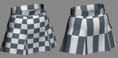

- Stretch Map Coords
- When on, the UV coordinates are based on the square bounding rectangle whose edge is the longer edge of the actual bounding box, and so have an aspect ratio of 1:1. When off, the UV coordinates do not maintain a 1:1 apect ratio but use the actual bounding box.
Left: Stretch Map Coords on
Right: Stretch Map Coords off
Figure group
Use these controls to specify locations for each panel on the figure to be clothed
- [button]
- Click this button, labeled “None” by default, and then click the object, or figure, to which the clothing is to be applied. Typically this is a character model. Thereafter, the name of the object appears on the button.
- Mark Points on Figure
- After specifying a figure using the “None” button (see preceding), use this control to specify locations on the figure for automatically positioning panels in the garment.
