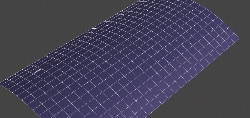

  • The Array modifier's Surface Distribution method creates clones using all or selected sub-objects of a target mesh, including vertices, edge centers, or face centers. The following example uses the Edge Center layout method to create stitches on a surface. See Create stitches on a surface using the Array Modifier for a detailed workflow example.

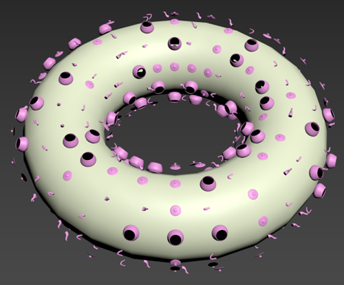

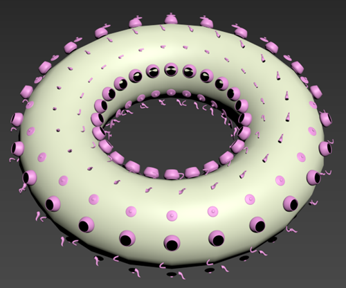

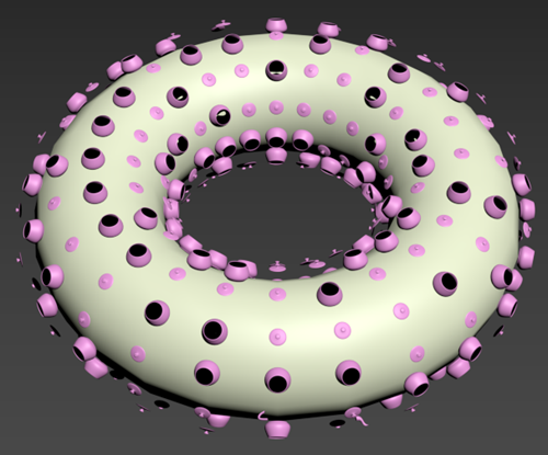

Array By Element
If the source object has multiple elements and this option is enabled, you can select from the following Array By Element methods to control the arrangement of clones. The following examples use the Vertex layout method.
  • Random: Each element is randomly used as a potential clone on the selected surface.
  • Ordered: Elements are arranged in sequential order on the selected surface.
  • First Middle Last: The first and last clone remain the same, and the remaining clones are arranged randomly on the surface.
    Note: A First Middle Last arrangement requires at least four elements in the object to provide the expected result.

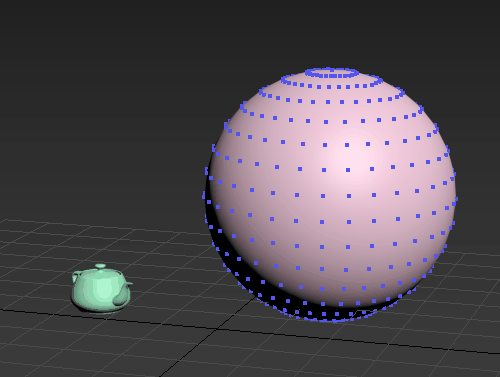

Use the Surface Distribution method to place clones on the selected vertices of a target surface
  1. Create a target surface.
  2. In the Modifier stack, click the + icon next to the Editable Poly entry to expand the sub-object hierarchy, then click the Vertex/Edge/Polygon item to activate the corresponding sub-object level.
  3. Make a selection on the target surface.
  4. Select the source object.
    This object is the source for all of the clones in the array.
  5. Ensure that an Array modifier is applied to the source object.
  6. In the Distribution rollout, set the following:
    • Distribution method: Surface
    • Layout method: Select a method. In the following example, Vertex is selected.
    • Pick Surface: Click this button and select your target surface. In the following example, Sphere001 is selected
      Tip: To select another target surface, do one of the following:
      • Right-click the Pick Surface button and select Clear Surface
      • Click Pick Surface and then select a different target surface
    The clones are placed on the selected vertices.
