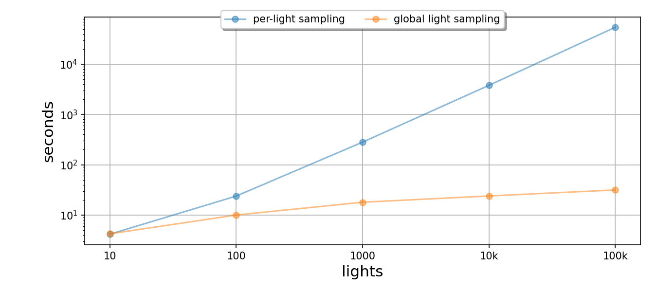

- Global light sampling: A new, more efficient sampling technique for lights is available. You can find it in the new Light Sampling group in the Arnold Renderer tab of the Render Setup dialog. When enabled, the light sample settings on individual lights are ignored and the overall, global contribution of all lights together is computed using the specified number of samples only. In this release, global light sampling does not apply to environment, directional lights, volumes, and GPU rendering. See the full documentation for more details. (ARNOLD-12860)
| without Global Light Sampling: 2 mins, 41 secs | with Global Light Sampling: 44 secs |
| For equal-quality renders of this scene, the new light sampling technique becomes progressively faster than per-light sampling as more lights are used. |
