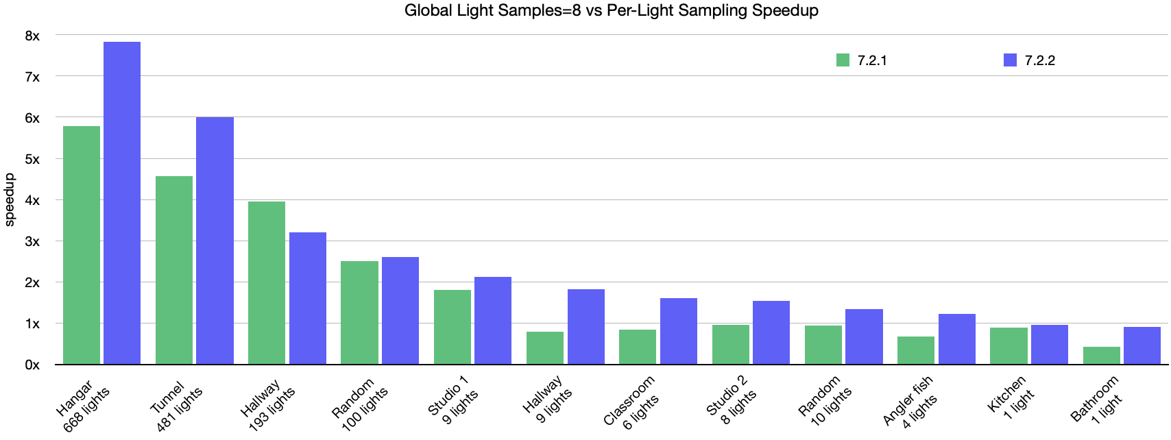

options.enable_fast_iprtofalse. An Arnold cache flush can also be used to trigger all nodes to update again. (ARNOLD-4873)Improved global light sampling performance: The efficiency of global light sampling with indirect lighting has been improved in many cases. See the global light sampling documentation for more details. (ARNOLD-13381)
