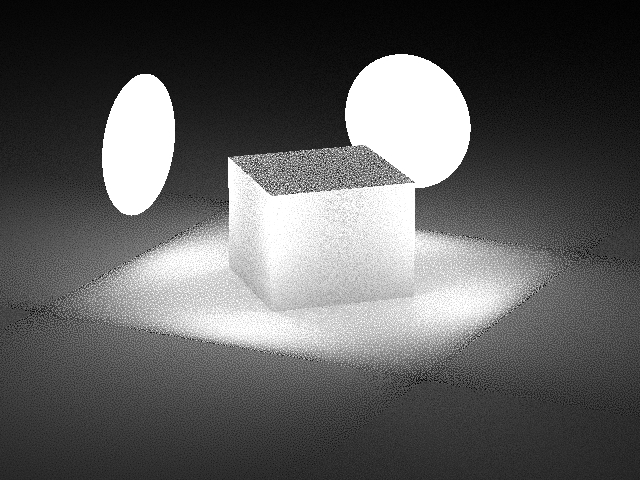

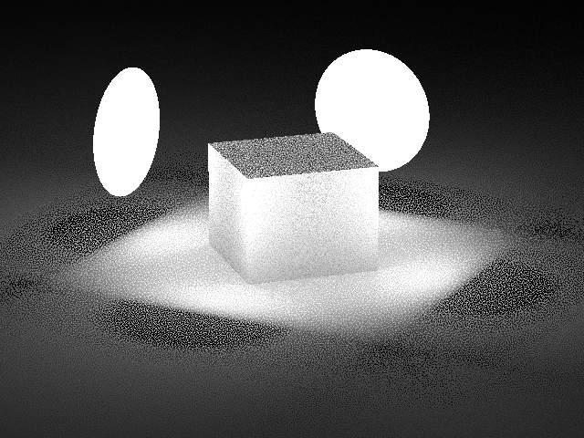

Improved Global Light Sampling behavior around flat lights: Reduced noise with Global Light Sampling for surfaces near or behind flat lights (disk or quad lights). (ARNOLD-13192)
