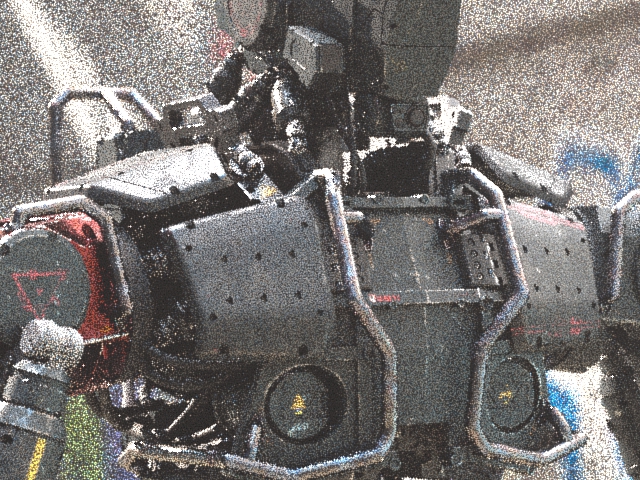

  • Progressive dithered sampling: Arnold now supports dithered samples in progressive and adaptive rendering. Dithering brings nicer noise distributions at low AA sample counts. (ARNOLD-10739)
