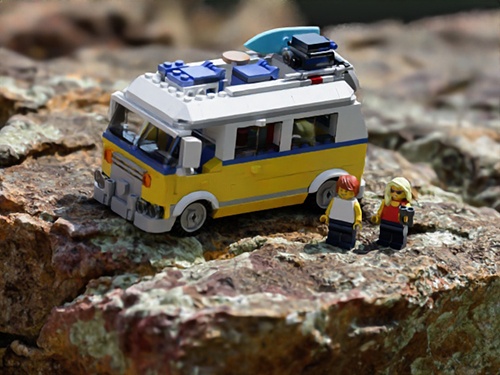

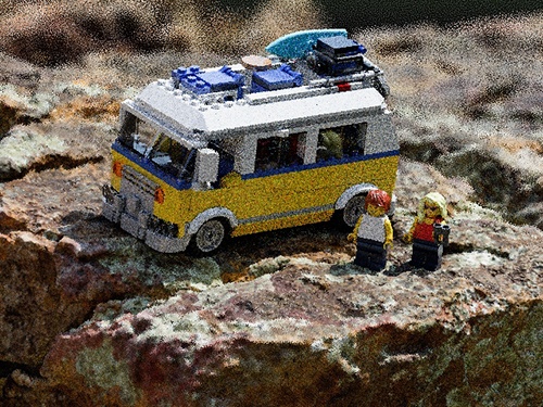

- Automatic Denoising: By default, new scenes automatically have an Intel ® Open Image Denoiser (OIDN) imager. A new option in the Render Settings controls whether a denoiser is automatically added when you create new scene. Existing scenes do not get the default denoiser. (MAXTOA-1745)
| without denoising | with imager_denoiser_oidn |

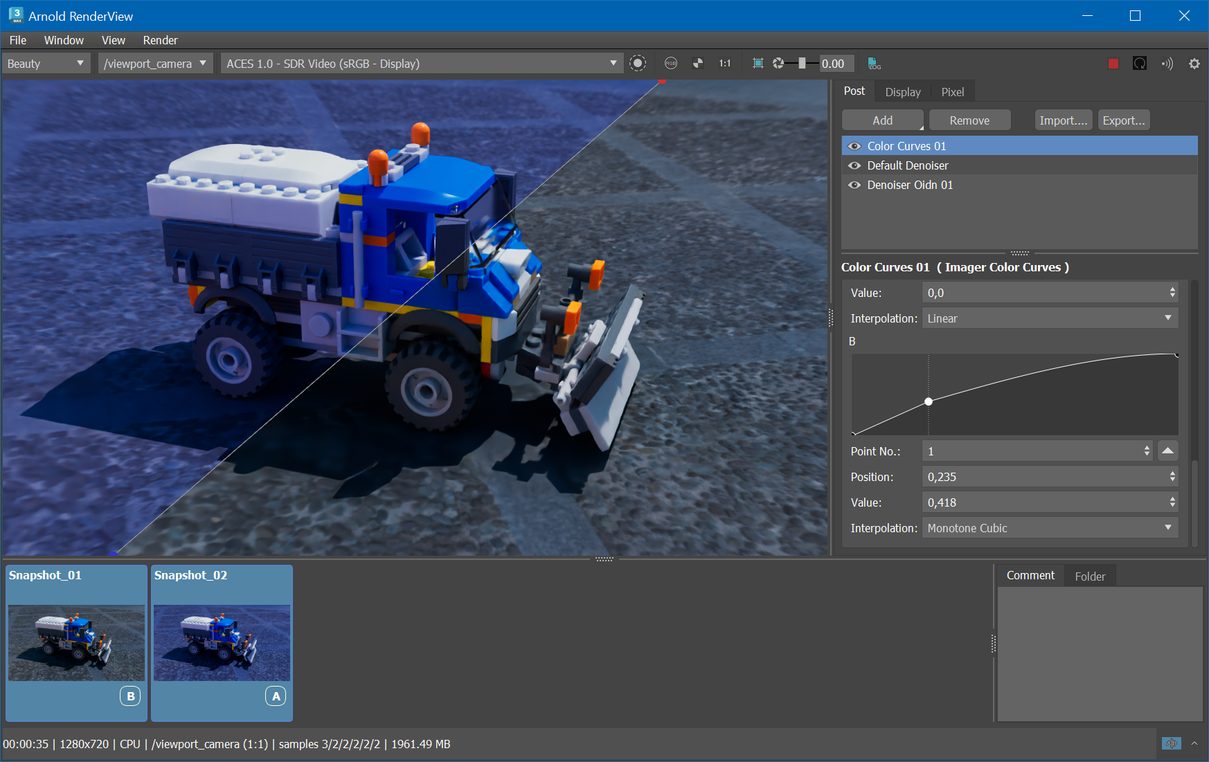

- Arnold RenderView Updated: Arnold RenderView (ARV) has new snapshot functionality and other polish. (MAXTOA-1727)
- Arnold RenderView is now dockable: The Arnold RenderView window (ARV) is now dockable by default, and follows the behavior of other dockable windows. If this is not desired, it can be turned off in the MAXtoA render settings. (MAXTOA-1722)

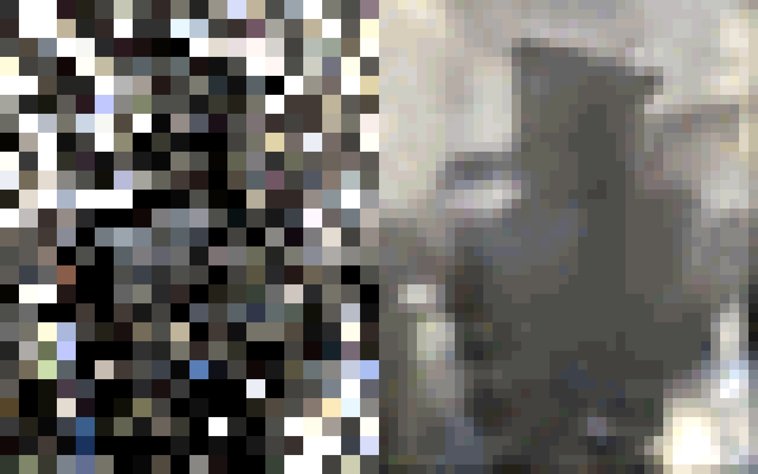

OptiX denoiser runs on progressive negative AA passes: The OptiX denoiser imager now denoises the low-resolution progressive passes (renders with AA < 0). This should result in higher quality feedback in IPR. (ARNOLD-11487)
| Left side shows the previous behavior where denoising was only applied to the AA > 0 passes. Right side is new behavior where all progressive passes are denoised. |
