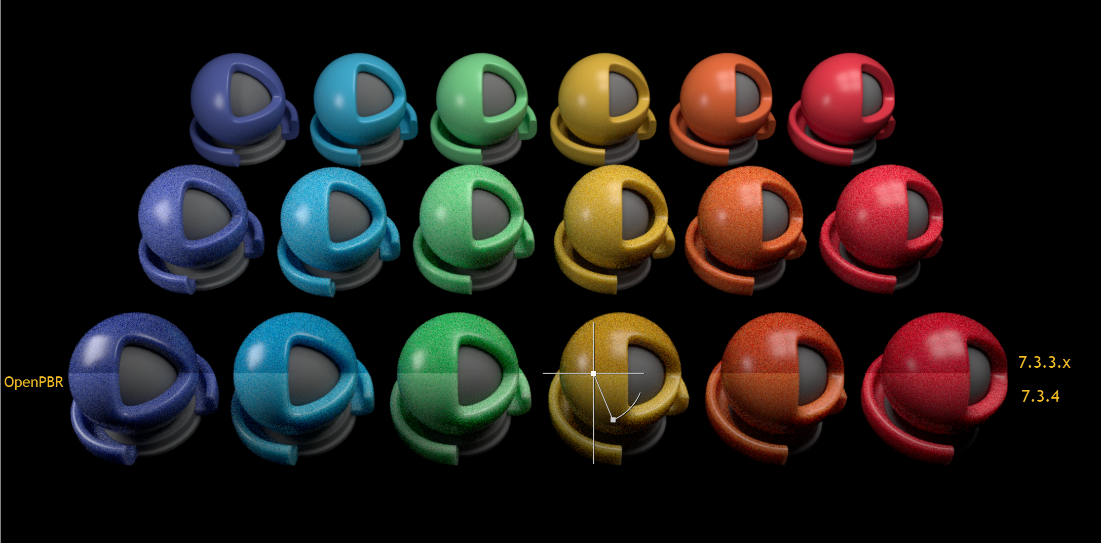

  • SSS color matching: The SSS model has been tuned to ensure that the color of dense SSS more closely matches the supplied subsurface_color, as required by the OpenPBR specification. (ARNOLD-15328) The following images compare diffuse base color with the subsurface colors of Standard Surface and OpenPBR Surface:
    • top row: diffuse with a given base_color
    • middle row: Standard Surface (dense) SSS, with same color assigned to subsurface_color
    • bottom row: OpenPBR (dense) SSS, with same color assigned to subsurface_color
