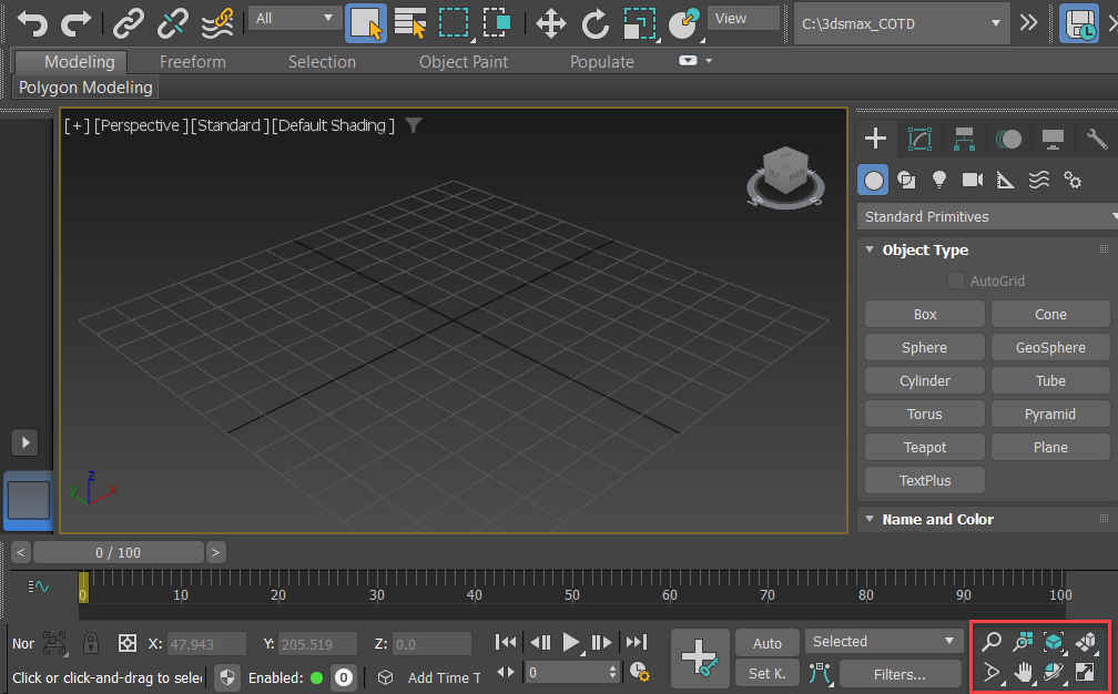

At the right end of the status bar are the buttons that control the display and navigation of the viewports.
The location of the Viewport Navigation controls
Some of the buttons change for camera and light viewports. The Field Of View button changes for Perspective viewports.
The state of the navigation-button flyouts for all viewport types is saved in the [Performance] section of the Initialization file.
