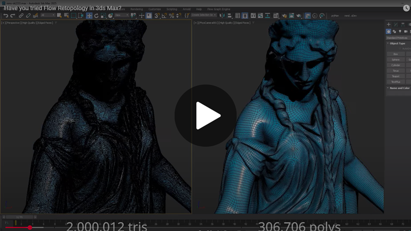

Flow Retopology is now included with your installation of 3ds Max 2026, and you can complete 50 jobs per calendar month.
See job submission details to learn more, and note that job submission details may change.
About Flow Retopology
Flow Retopology works just like 3ds Max's Retopology Tools, simplifying complex geometry, making it easier to work with. Flow Retopology leverages remote cloud computing to process mesh operations, letting you continue to work in 3ds Max while the job completes. With Flow Retopology, you can run several Retopologize operations simultaneously, even on a single mesh with distinct settings for each operation. This parallel processing, separate from your work in 3ds Max, saves time and increases efficiency.
