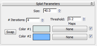

Splat is a 3D map that generates a fractal surface pattern that is useful as a Diffuse Color map for creating a pattern similar to spattered paint.
Note: The Splat map is not supported by the ART renderer.
  • Material Editor > Material/Map Browser > Maps > General > Splat
Splat map used for the patterns in ice cream
Interface
Size
The relative dimensions of the paint spatters. Use this to make the spatters match your geometry. Default=40.
# Iterations
The number of times the fractal function is evaluated. The higher the number, the more detailed the spatters, but the longer the calculation time. Default=4.
Threshold
Determines how much of Color #1 is mixed with Color #2. At 0, only Color #1 is displayed; at 1, only Color #2 is displayed. Default=0.2.
Swap
Exchanges the two color components.
Color #1
The background color.
Color #2
The color of the paint spatters.
To change a color, click one of the swatches and use the Color Selector that opens.
Maps
Click to assign a map to replace one of the color components. Toggle each map with its checkbox (when off, the Splat map reverts to the associated color component).
