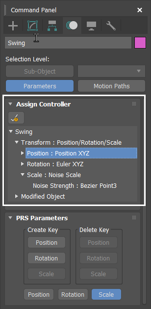

The Assign Controller rollout is a Motion Panel rollout that lets you assign and append different animation controllers to individual objects. (You can also assign controllers in the Track View.)
The Motion Panel Assign Controller rollout (highlighted)

To view the Assign Controller Rollout
Select an object and click the . The Assign Controller rollout is the first rollout on the panel.
