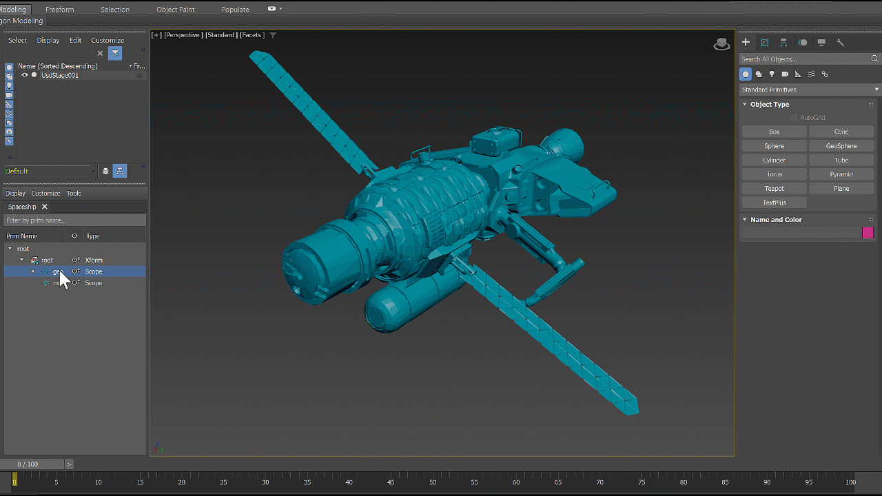

Promote to 3ds Max Object. You can now promote USD geometry to a 3ds Max object to work with it using native 3ds Max tools.

Improved USD stage object interface. We've enhanced the USD stage object UI in the command panel and added a button for launching the USD Layer Editor in the new tools rollout.
