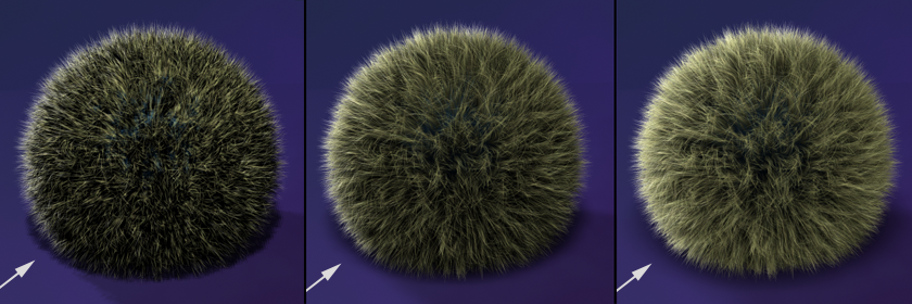

Fuzz
Sets the softness of the shadow edges.
Left: Fuzz=0.0
Center: Fuzz=5.0
Right: Fuzz=10.0
The arrow points to the shadow cast by the hair on the underlying surface.
