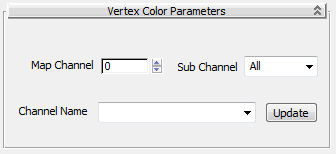

Interface
These parameters let you define which map channel or sub-channel is to be rendered. One application is to support usage of the Vertex Color map in conjunction with the Channel Info Utility.
The settings are interlinked; changing one parameter will change the other two, as appropriate.
Map Channel
Lets you specify which map channel to use. Range=0 to 99. Default=0.
Notes regarding this setting:
  • If you set Map Channel to a channel that doesn't contain any vertex coloring data, attempting to render will generate a Missing Map Coordinates error message. To resolve this, apply vertex coloring to that channel.
  • By default, the vertex coloring in map channel 1 is a color gradient derived from the UVW texture coordinates by converting UVW values to RGB values. Thus, at UV=0,0 (the lower-left corner of the map), the coloring is black; at UV=1,0, the coloring is red, and at UV=1,1 (the upper-right corner), the coloring is yellow (red + green=yellow). You can change these colors with a tool such as VertexPaint modifier.
  • Map Channel cannot be set to a negative value, thus the map doesn't support rendering of the vertex illumination (–1) or vertex alpha (–2) channel.
Sub Channel
Lets you can specify that the map will use either the Red, Green, or Blue sub-channel of the specified map channel, or all sub-channels.
Channel Name
After assigning the material with the Vertex Color map to an object with named map or vertex-color channels (see Channel Info Utility), you can click Update, and then, from this drop-down list, choose a named map channel from the object.
Update
Refreshes the contents of the Channel Name drop-down list. Use Update after applying the material to an object, or after adding channels to the object.
Note: There could be conflicts if one material with a Vertex Color map is assigned to objects with different named Map Channels, where one channel's name may be displayed in preference to another's.
