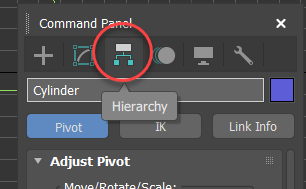

Hierarchy Panel
Found in the Command Panel, the Hierarchy panel provides access to tools to adjust the hierarchical linkage between objects.
The Hierarchy panel
  • Command panel > Hierarchy panel
